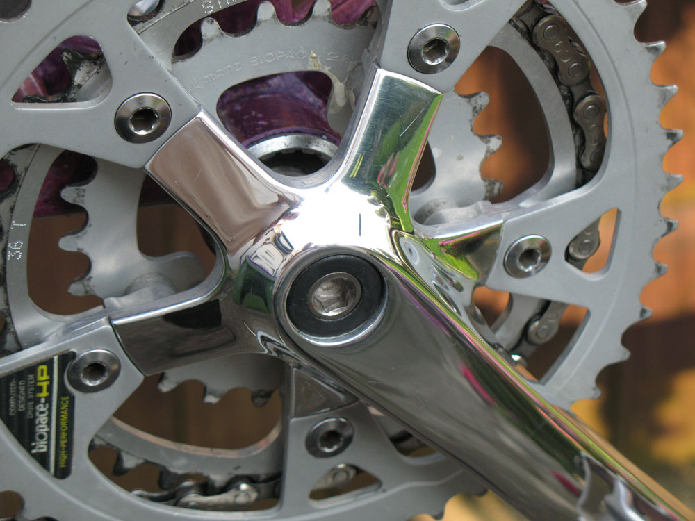

I've achieved some pretty good results with Brasso, you can see I've still got some marks left; I ran out of patience:
Wow, that looks really nice.
My old flatmate used steel wool on his Zaskar and that came up quite nicely. If using steel wool it may remove the lacquer but shouldn't damage the frame (stripping the lacquer seems the thing to do first!). I have in the past used wet and dry on a set of cranks and gave up on them as I was doing it by hand and simply lost the will to live trying to get it polished up so beware! Though you seem more sensible than I was...
