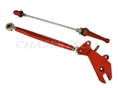

i have an alternative adapter (see image below). all you would need is a longer skewer to fit it (i've been told you can get them for tandem bikes or bikes that require them fro trailer attachments)
