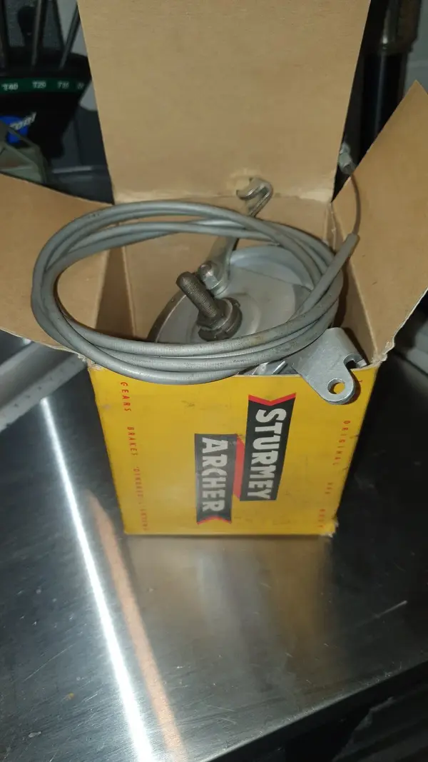

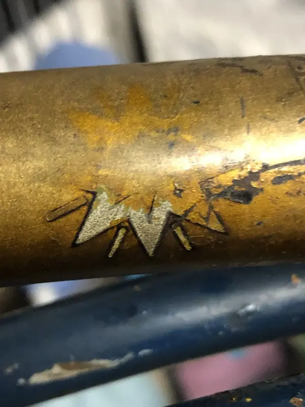

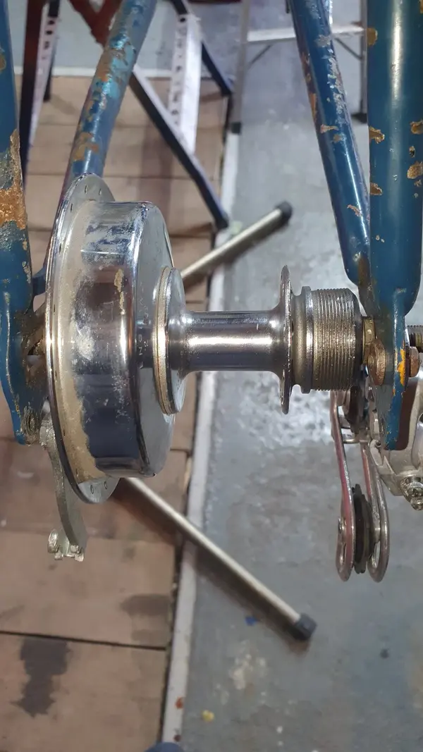

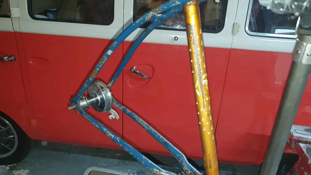

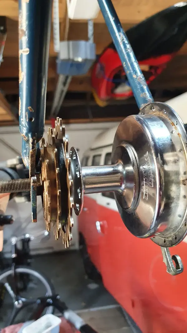

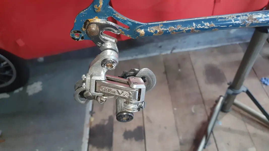

And decided to go down the Suntour gearing route as these were readily available in the UK in the late 70's
With the help of @Peachy! had a rummage in his old road bike parts stash and had play with a few freewheels to see if I could get away without spreading the frame. Even a 3 speed freewheel catches the chainstay, so I guess the frame will need massaging...if only Bob Jacksons was still open 😔 20210918_132630.webp
