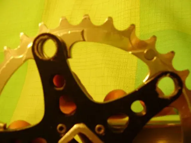

I have attached a photo below of a 34T chainring on Middleburn cranks, the teeth of chainring seem to be too close on the spider which the chain will touch it when fitted on so I am looking for 36T onwards to keep the chain away from the spider, what gearing I should have to match the gearing above?
Thanks

Cheers, I will work out gear ratios from your tips here and Sheldon Brown's (thanks kaiser), so far it's I am looking at 36x18 gearing.
