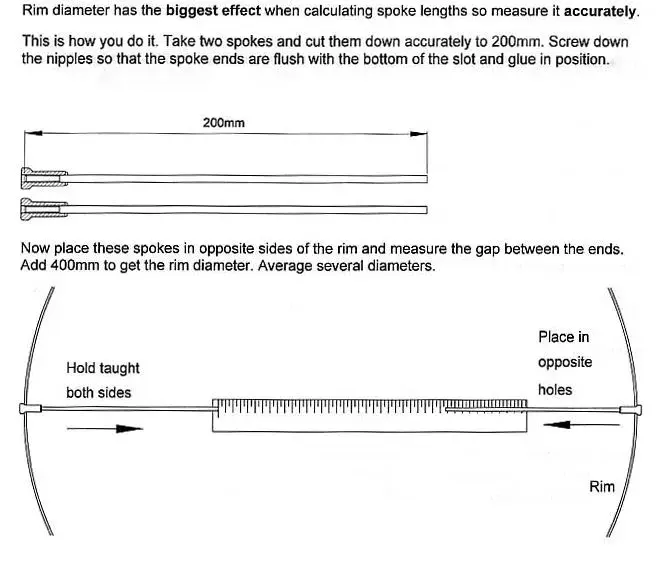

There are loads of spoke calculators on line. They will all ask for some dimensions from you such as ERD, drilling, spoke cross, OLD, Flange Measurements. This is what I use to measure the ERD
That's interesting , not heard of that . Would a rear track wheel have the same length spokes ?
