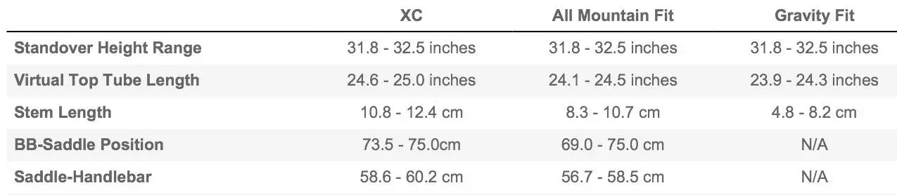

Interesting. I come out at MTB 19.5" Road 58cm (6'3" 33.5leg)
Well that one was a faff! Gave me numbers that mostly have no relation to frame sizes you can see on majority of listings or websites. But reach helpful?
Most should give standover height and virtual top tube length.
But remember that will be modern bikes so long forked and short stemmed relatively.
I think i've shown you the kona charts before.
