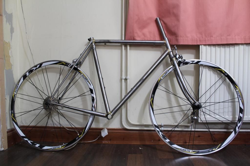

Apologies I'm bringing an old thread back to life but I went back to finish the frame and make the forks last week and I thought you might be interested to see the result.
I'm pretty pleased with how it turned out and have made loads of notes which will enable me to make a better job of it next time.
Speaking of next time, I also bought the jig that I used to make the frame so this could be the first of many. Just need to set up the rest of the workshop now - turns out that you need quite a few tools to make a bicycle frame and there aren't many shortcuts to be taken.
The frame itself is now ready for priming and spraying I've just got to buy a moisture trap for my compressor, oh and the paint. I've decided to build this one up with only brand new modern parts (mostly Shimano 105) which'll be the first time I use such modern (!) things as threadless headsets and non-axle bottom brackets. I'll post a pic of the finished bike if anyone's still reading. As you can see I'll have to wait until it's sprayed and assembled before I take a hacksaw to the steerer tube.
Should be finished in time for some fair-weather spring-time riding.
