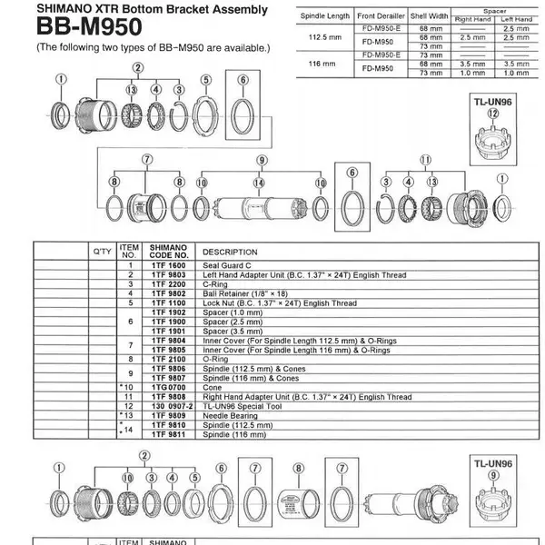

Here you go.
This is an exploded diagram of the BB-M950, which may help with pulling yours apart. That's if indeed my memory is correct, and it is possible to do this:
Pip

pipmeister":14g901yw said:
Here you go.
Pip
Wow. That is mega useful, thank you very much indeedy!
Is there any significant difference between the 952 and 950?

Out of interest what dimensional differences between the 73 and 68mm versions. My one measures 63mm from the inside of the drive side cup to the edge of the bottom bracket case (piece 8 on the lower of the two types shown in the diagram).
