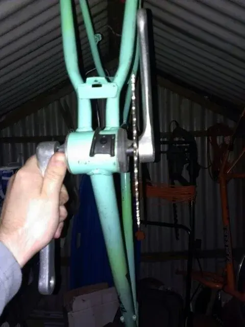

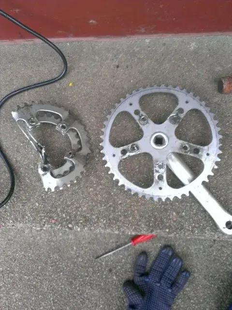

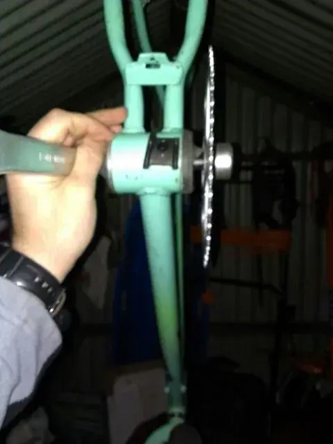

So after much swearing,hammering,crowbar and dremel I converted my old three piece crank into a single.

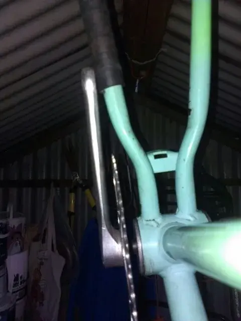

Crank arm seems to be rubbing on the chain stay,just hoping it's because of the diy chainstay protector and I haven't dunted it.

That ring looks badly out of line, remove they thick rubber chainstay protection and spin that cranks.
Single ring cranks are quite cheap on the bay.
I suspect that drilling out the rivets would have been better. Bearing in mind the mangling of the inners :shock: , I can't believe the outer is still true...

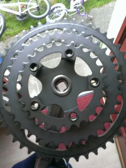

This is the original pic,think all that has happened is I have made it sit closer to the frame by taking the other two rings off,can you buy spacers to push it back out a bit?
