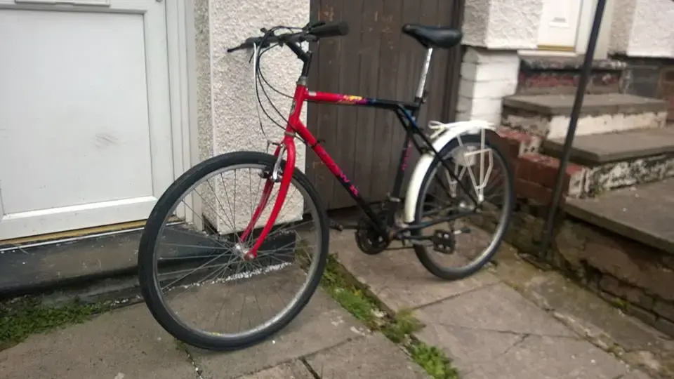

get some pics up.
this is the latest picture I have of it, just before I redid the cables and properly got the wheels on today (they were loose in this pic).
im going to be using the bike pretty much everyday, for commuting, taking my little sister around the park, fun rides on the weekends but nothing like hitting Cannock chase lol.
I want to change the handlebars purely because if I stay in one position for more than 15-20 mins my back starts to ache and having recently ridden a bike with bullhorns I found that being able to change my position regularly over a 60 mile distance was quite nice. ive had bullhorns before but im getting back into cycling seriously now after some health issues and im covering quite a bit of distance regularly. the bike I rode with bullhorns had grips and not bar tape on so I think ill get a set from LBS if they have any.
im umming and arring about the 7 speed rear change, it might be worth it, it might not, the bike will need new wheels in 400 miles anyway so if im going to get new wheels the opportunity is there to convert and get new derraileurs etc while im there but bending frame etc and just risking more stress on a certain area - im not keen on.

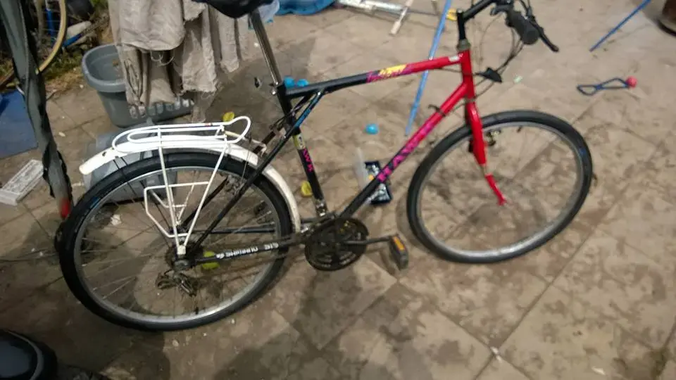

this is already kind of turning into a project -

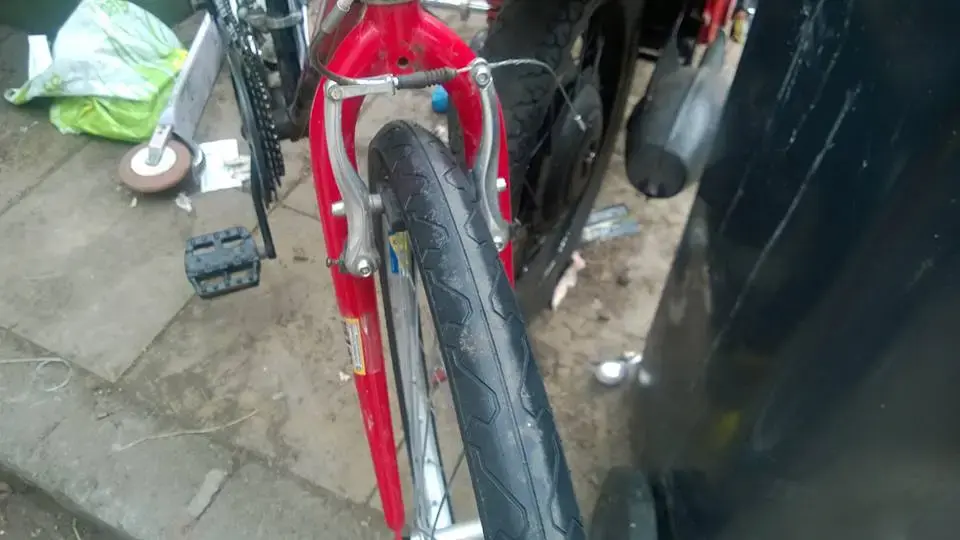

I was messing around with the brakes trying to set them up so I didn't have to replace with v-brakes, the rears work OK now. the fronts just weren't playing ball, so off upto the top of the garden I went, found a bike with v-brakes. took the front set off which happen to have good pads and a cable, installed them onto the hawk, 5 mins of messing (mostly drinking my cuppa) and they were on and adjusted properly. v-brakes are so simple, I just love them. do need to change the outer cable but for now, theyre working and that's what matters.
No harm or problem on it not being a yeti or anything. I think 3/4 of the battle is getting something that fits and is comfortable no matter the distance 8)
And sure, building up in period kit is desirable though not set in stone and tbh why not fit a few bits it wouldnt have had on originally if it makes the ride more comfortable or sheds weight, and shedding weight is a must for this :wink: :lol:
one of the major things for me is getting the right fit, im 6 ft 7 so i need to have a frame that fits nicely and be able to adjust it to how i want it. every other bike ive tried, ive never managed to get the fit right apart from on this and the short period where i had my RSP built up. im not bothered about weight etc as i ride with panniers on the rear 99% of the time, cant really remember the last time i rode without panniers and i dont bother going anywhere too fast. the biggest things i focus on are comfort, handling and stopping. this bike does it well enough for me.
i tried out the bar ends and just didnt like them so im going with bullhorns, that will be tommorrows job.
pic of front v-brakes
