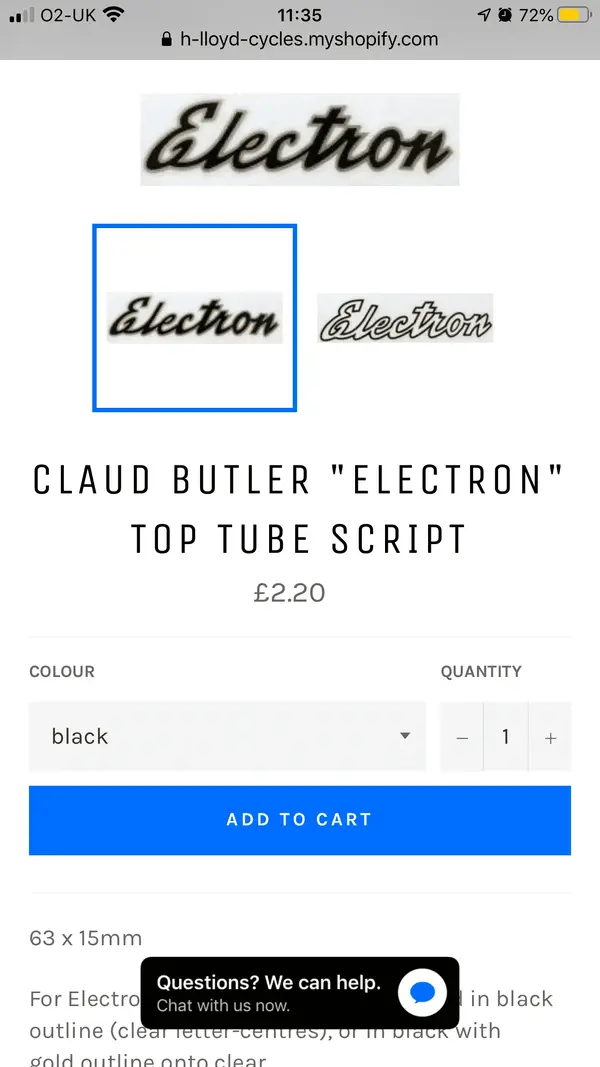

H Lloyd cycles have everything you need decal wise. I’ll make up a list for you when I get home, although measurements from Jamie would be helpful if you want to get the placement spot on.

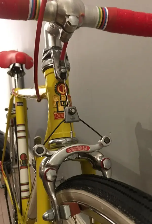

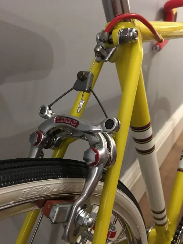

I think this frame size should have 27” wheels, maybe the weinmann’s that have been fitted should have been the shorter version?
My sons Electron is a 19.5” frame (smallest in the range) with Weinmann vainqueur ‘999’ brakes (750 back, 610 front) & 26” Van Schothorst “Silverseal” chrome steel dimpled rims.

Here you go.......
Top tube Electron name, likely to be the black with gold edge as the outline version was normally only seen on lighter colours.

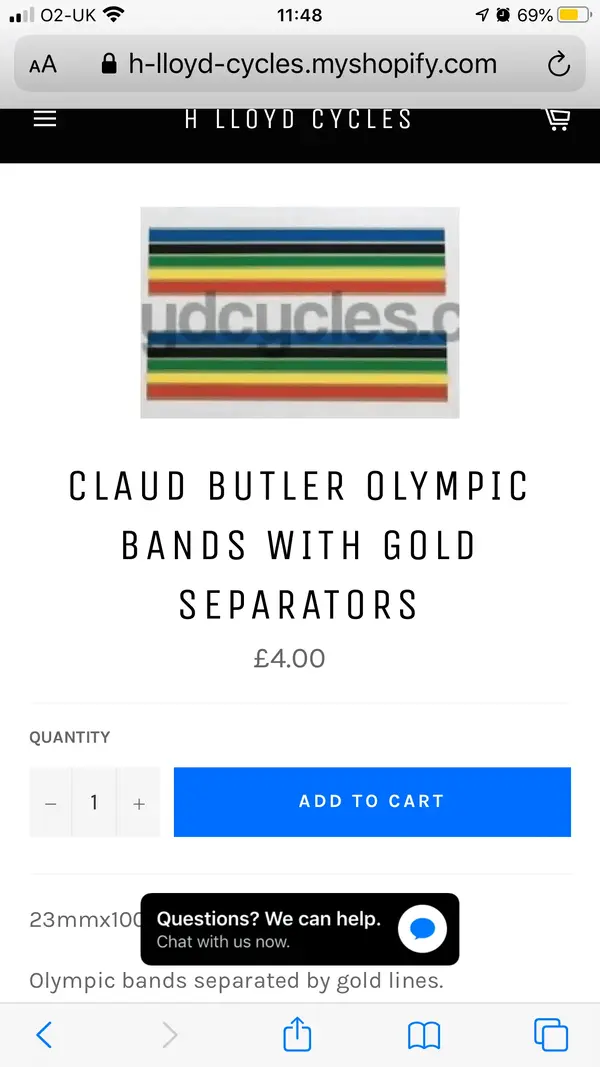

CB Olympic crest, middle of seat tube. Make sure it’s the London England with yellow ring. This lasted till mid 1976.
Bands, I don’t think they were the 23mm gold lined I think they were 16mm gold lined, that’s what we used on our Superfive, but I can’t find them. Maybe ask Jamie to measure his?

Awesome.....above and beyond Peachy! Much appreciated. I was unaware that H Lloyd offered quite so many decals!
I have the remnants of the bands on the seat tube for reference and also ghosting of where the missing ones once were so I think positioning should be easy to work out.
