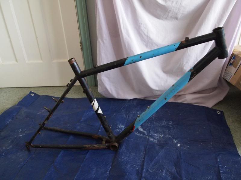

Finally sorted a box to post this in.
18.5" Centre-Top
Lots of surface rust from a terrible paint-job, but the BB shell seat-tube and head-tube are all nice and clean, so a good blast and powdercoat should have it looking great. No dents/cracks
£40 posted via Paypal gift or collected from Brighton for £30.
Cheers,
Dan
Any idea what tubeset this is please.
and what length fork it is designed around
oh and also the measurements for centre to centre / top tube measurement and the fork head size , bottom bracket shell size, seatpost size please :facepalm:
DB chromo tubes, this looks like an 18.5 , not sure on tope tube 22.5 -23.5 i would say, takes 1 1/8 headset, from memory 68 bb shell( confidentmemory) , seatpost 27.2 .
beautiful riding frames with the lovely snaky stays , might wanna make him an offer though, as you are going to need a powdercoat and some decals which are gonna push the price up.
i have links to some ai voodoo files, not quite right but would give her her identity back if you wanna do it on the cheap.
headbadges can be got too.
always worth contacting voodoo too
if i was you i would get a cheap powdercoat and cheap decals made and then see how you like her.

are these prone to the tubes rusting through , I know you mention surface rust but dont want to have to go down the road of replacing the tubes out.

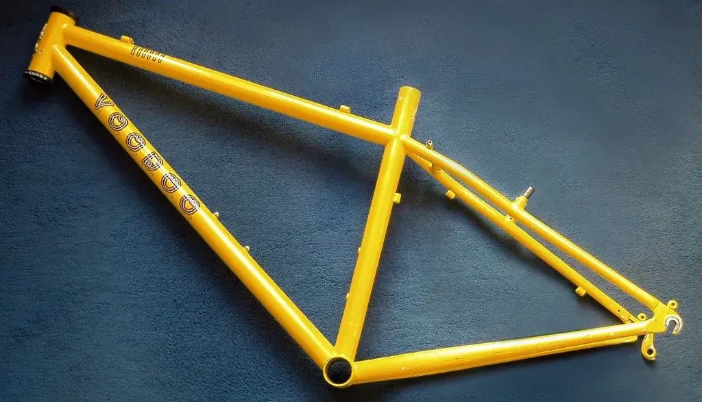

I would say no, and Dan's description looks very fair to me - it does need a respray, ideally back to its original colour (see below), and I would guess that would resolve all the rust issues.
