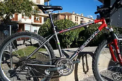

That frame was for sale on here and MTBR. I thought it sold through MTBR, looks like the new owner is looking to punt it on already (for a small profit too?).
I don't like the red-painted front. It's as though someone in Marketing said 'what can we do with the Hei Hei for next year? We can't just leave it as plain titanium.' To which the correct answer would have been 'why not?'
There used to be a saying 'a man who is tired of London is tired of life'. Maybe they should say the same about titanium.
For once (or twice) I disagree Anthony. I think full bare metal Ti is rather boring.....the decals on this look good. although I would prefer a diff. colour.
Oneday when I have my Ultimate..it will be half-painted Ti 8)

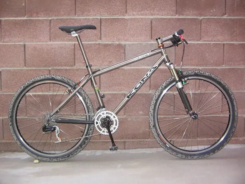

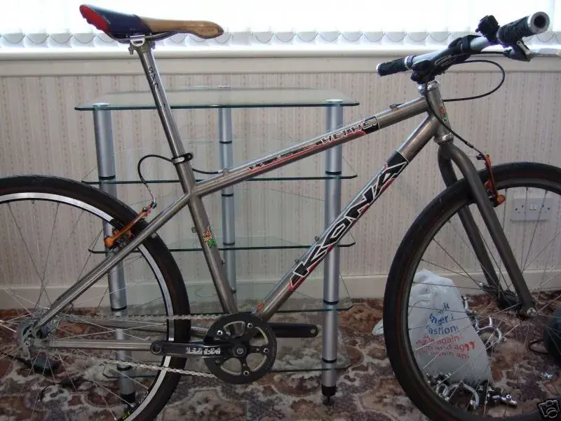

All a matter of taste Carl, but funnily enough I believe that the 1999 Hei Hei was also sold without the red front* and almost all of the ones I've seen have had the ti front and not the red. But personally, I like the look of Mr Zero's 1998 example the best of these.
* An alternative hypothesis is that the plain-front ones were 2000 Hei Heis, even though such a thing was never listed. The look is not dissimilar to the 2000 King Kahunas, aside from the red flash on the decals.
