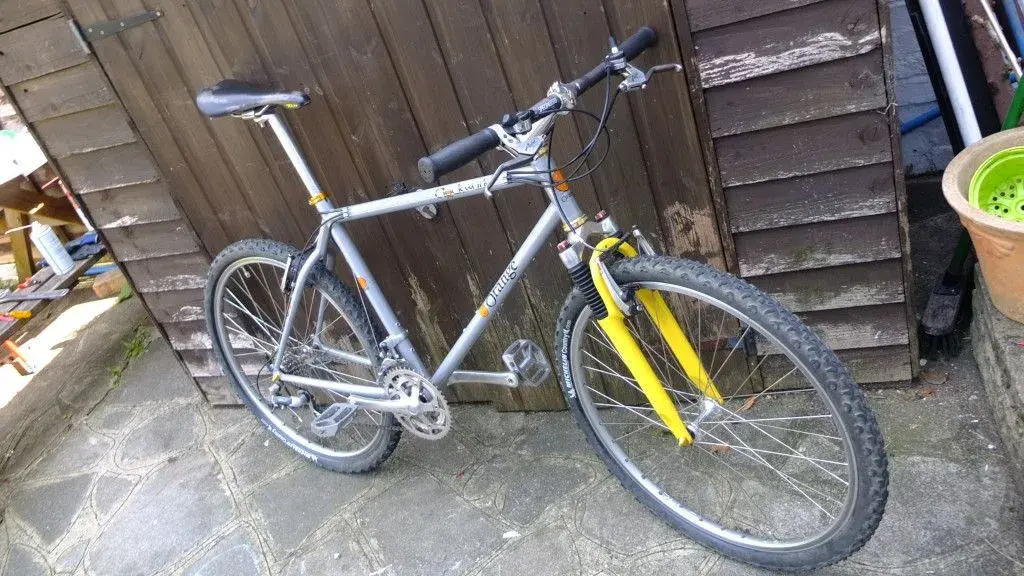

Done! And ridden (round the block anyway). It's nice!

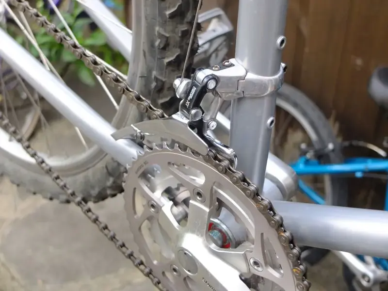

A few tweaks to make, shifting's not as crisp as I'd like (need to check rear derailleur/hanger alignment), and also I'm wondering if the cage of the front mech might be slightly misaligned/bent... plus wheels need a fully OCD true-up to be 100% (in which case I can also get the brakes adjusted better). But hey, chasing perfection isn't why I've put this together, and besides I think I need to ride it a bit before getting too carried away with the spanners.
I'm chuffed. Build feels super light compared to what I've been riding recently and on a quick road test it feels both comfy and quick. I like the way it looks too.
Can't wait to take it on a decent ride!

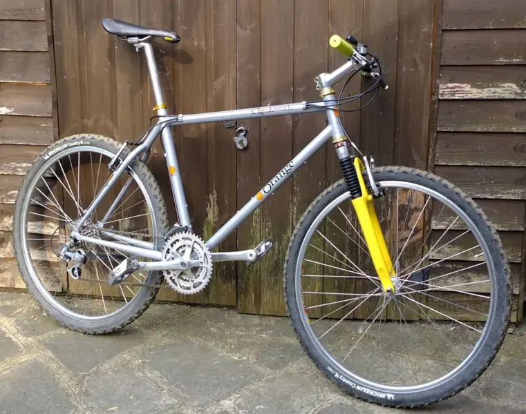

Have taken it for a decent ride now. It's brilliant. Also got hold of an M736 front mech which is much better. It's amazing how quickly the quality of XT stuff went down hill in the mid 90s (once XTR came in?)
Would like to swap the brakes for some earlier ones in terms of the looks, although having adjusted the pull on the levers the current M750 ones work brilliantly.
Forks seem to be getting worse though! Really bottoming out easily, so soft. Need something else... or a rebuild...

I think your problem with the front mech was using a later hyperdrive-c mech with the older non compact drive m730 chainset. They do not deal well with the bigger chainrings. Now you have matched the mech to the chainset it obviously works.
Fork problem will be the elastomers. You can't seem to get decent micro cellular urethane any more, most people use solid urethane rod and chop it to fit, or buy pre made ones from the internet. They are better than mushy old elastomers but not as a good as new originals.
The indy sl are actually pretty good when on form, and exactly the price point of fork the c16 would have had new.
Like the colour and decals, but please oil your chain!

Not sure re the front mech... the issue was not shifting to the bottom ring, and I'm pretty sure the cage is bent. I compared it to a very similar (good) LX one (same era), and the XT one definitely looks wonky in a manner which would explain it (i.e. the lower outer part of the cage is bent away from the frame). It just won't push the chain over far enough, unless you set it at a funny angle, in which case you get clearance issues. OTOH, it could be a combination of a slightly bent mech and marginal compatibility... :? Anyway sorted now so it doesn't matter, and as you point out the new one is more in keeping with the spec and vibe elsewhere.

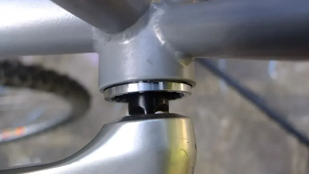

What width Bottom bracket are you running? If it’s too narrow for the cranks the inner ring will be too close for the mech to shift down to it properly.
Re: Re:
Ha! Funny you should ask. I had the bike turned upside down this afternoon and noticed that the cranks are sat closer to the frame than they ought to be. I remembered that I wasn't sure about the BB when I fitted it a few years ago - it was the best I could find in my parts stash, and I made a mental note to check it later...forgotten :facepalm:
...So yeah, currently it has a 118mm BB which is a little too narrow, also the chain line isn't brilliant which explains the less than crisp shifting to the lower gears at back. I guess I'll order a 122mm UN55.
Oh well, I'll get there. :roll:
Pulled the 118mm TH Industries bottom bracket and fitted a 122.5 Shimano UN55.
The gap between the small ring and the frame has grown reassuringly (previously it was practically touching) but oddly following an attempt to re-align the mech I still had shifting niggles. I'd noticed previously that to get it to shift properly I'd ended up with the mech at an angle. Even now, with the mech straight it hits the frame before the adjuster stop, so I've had to angle the mech in at the back to get enough movement.
Also another niggle (I'm being uber fussy here) is that the R/H cup on the new UN55 has a lip which looks like it is supposed to fit flush with the frame. Well it doesn't. Instead it leaves a little gap that looks like a great place for dirt and grime to accumulate...
Anyway... at least the chain line is better so it is one step closer to that fictional ideal...perfection.

Sorted this morning. Mech hanger was bent. Shifts a treat now. Also finally managed to get the front mech properly aligned and working as it should. In addition to the narrow BB, it would appear I had the mech mounted too high. I should know better. Still, you live and learn.

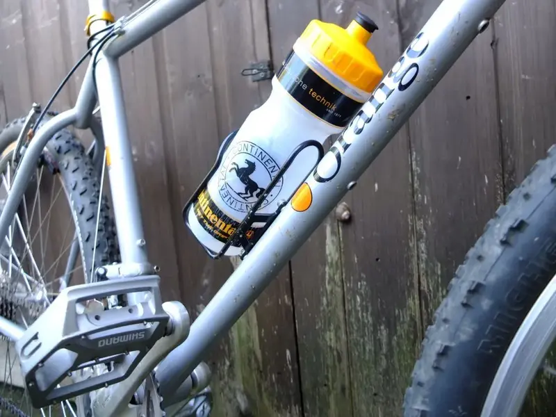

Today I finally discovered what a lame excuse this is... Took the bike out to Epping Forest this afternoon, only half an hour's drive away, had a great couple of hours aimlessly exploring. Got lost and completely knackered. Absolutely wonderful.
Look, it's got mud on it. :)
