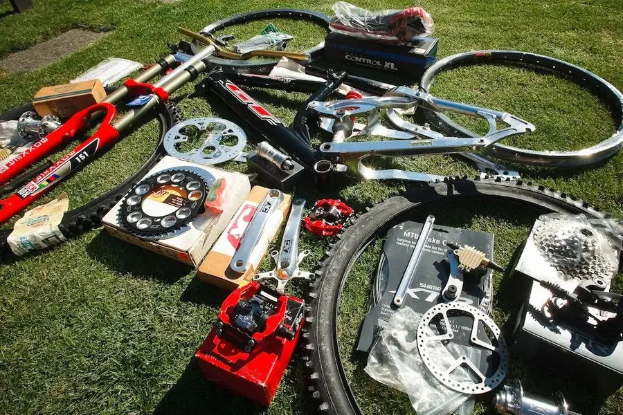

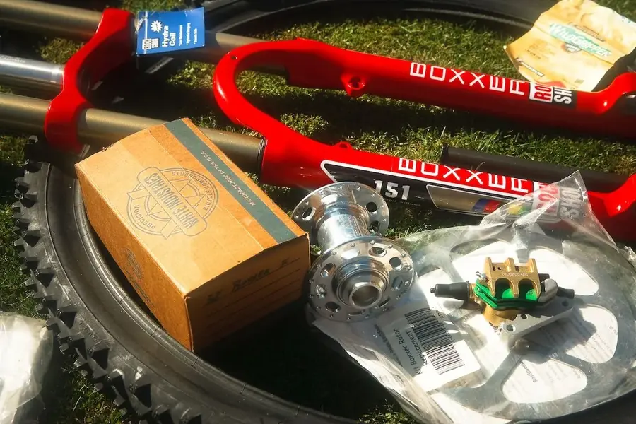

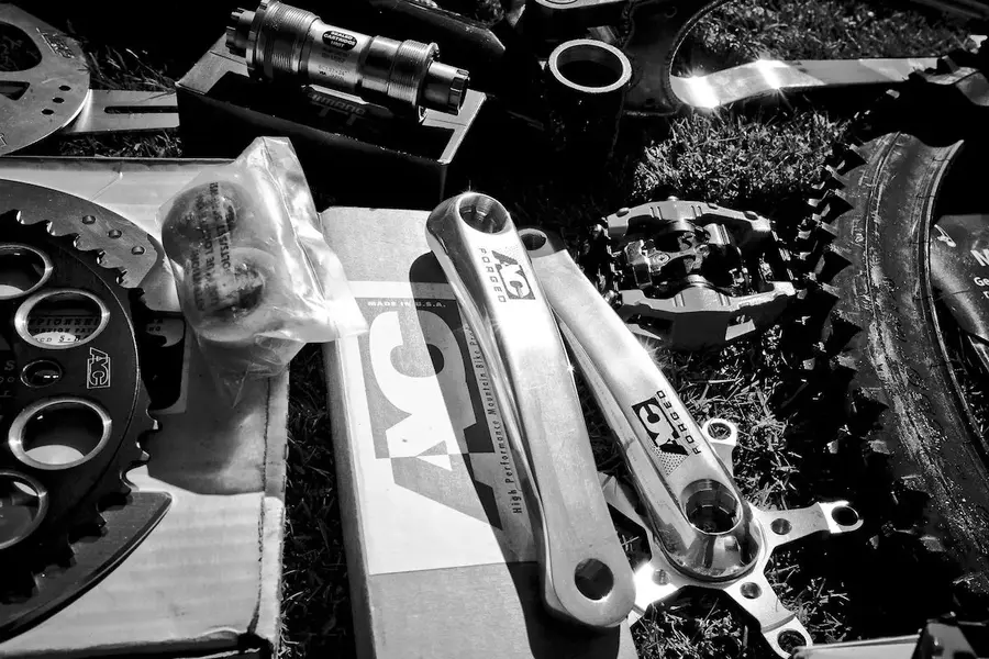

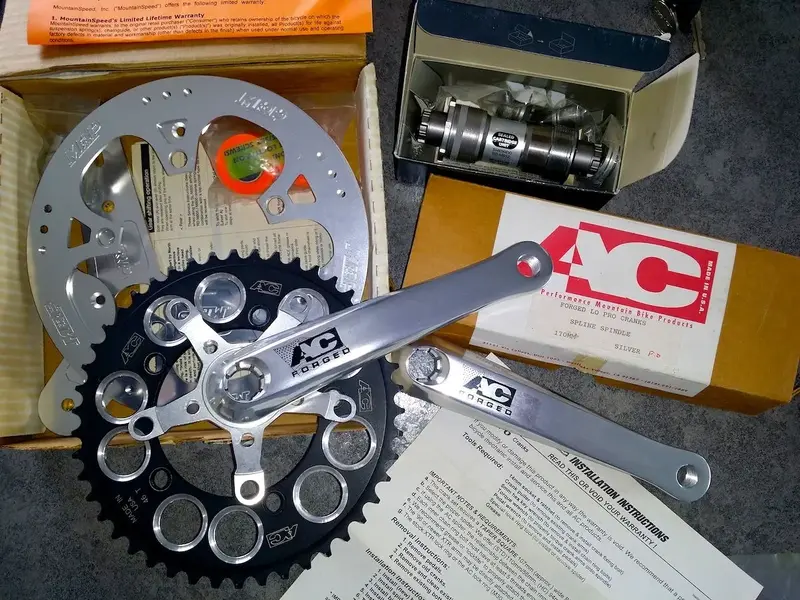

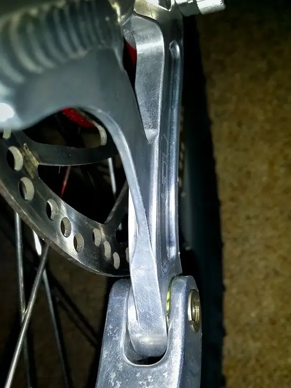

front is same as back hope c2 but num 6 ( both nos and note the non cnc levers )
It was after posting I noticed the front on the first page :oops: Must have been pretty hard to find those :? more a UK thing.
Though that said I know everyone had them if they rode professionally . Still cant be many nos about out your way.
Ive also a pair of the non cnc lever blades. Not a lot of them either :?

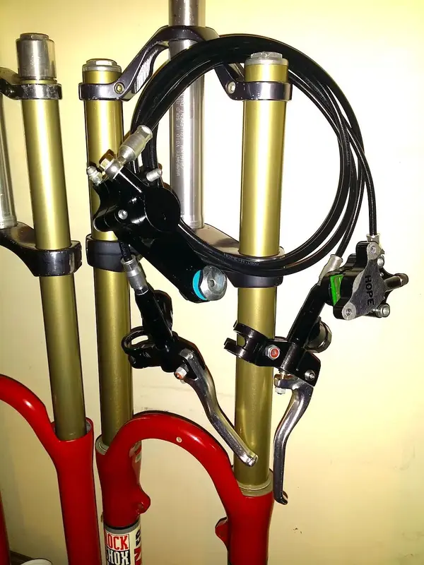

Have you seen the short wide lever blade ? the one with the threaded hole in the end ?
found them in usa on ebay $100 usd figured not bad price for nos brakes
(were listed as brakes .. .was share chance i found them)
and no havent seen the short levers

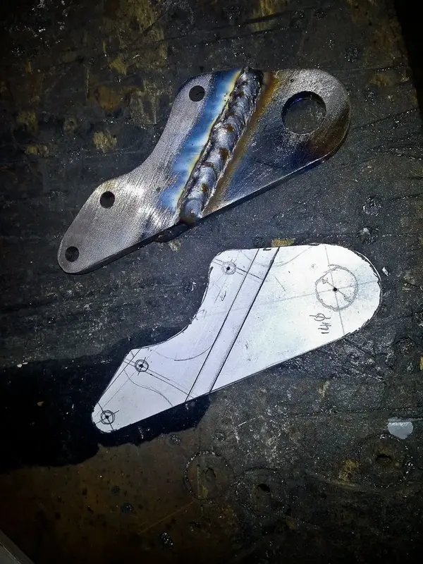

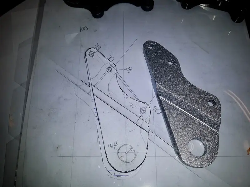

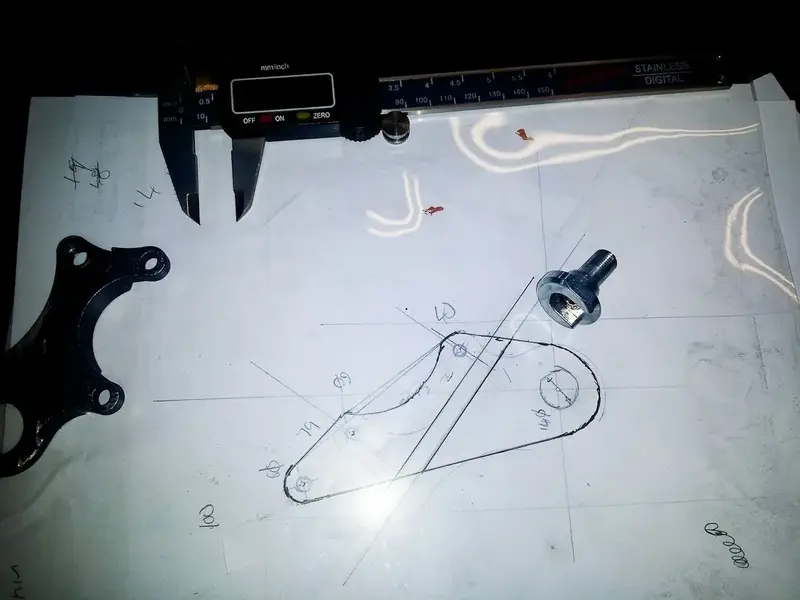

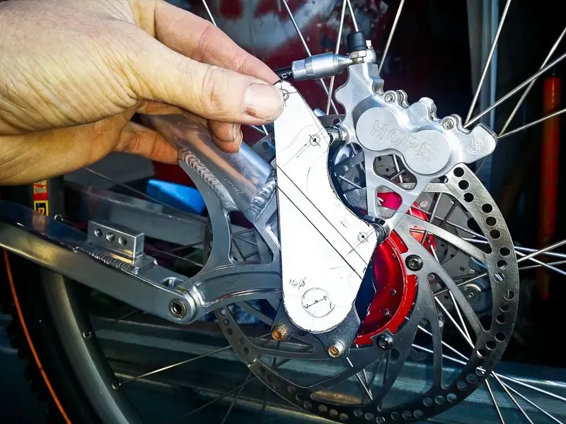

99 lobo rear brake mount was next issue wanted a floating set up but wanting to run a 180mm rotor (damn tight squeeze but fits )
sooooo bit of drawing first ( copy existing floating mount Ish lol :wink: )
next cut n see if will wrk
next marking out used 6mm steel (bit heavy but wont break in hurry )
next weld and drill holes
and sand and paint :D (and now wait until i get axle shortened and finish pivot hole )

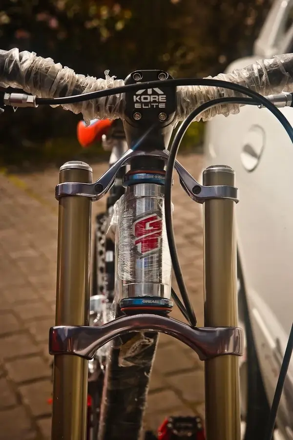

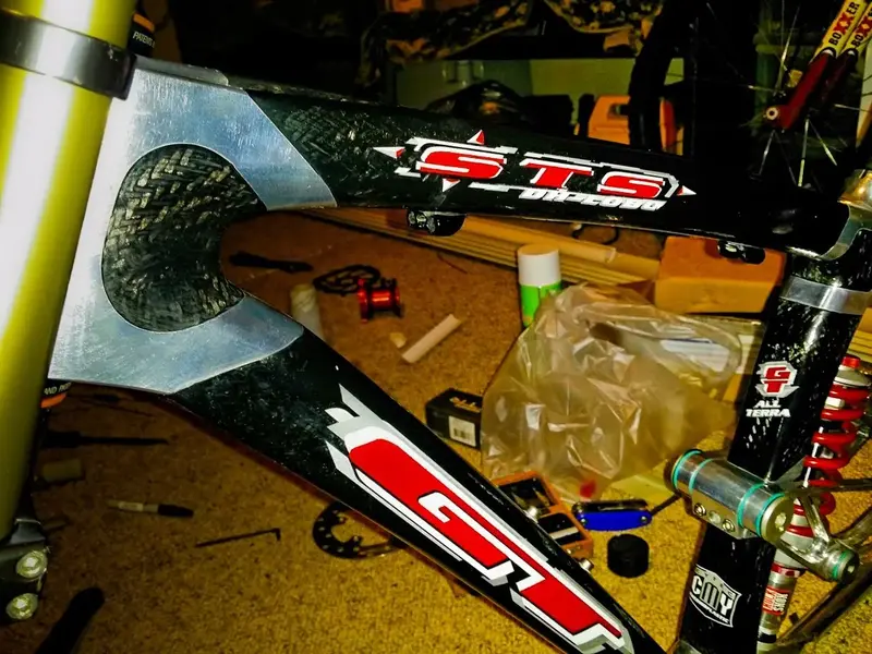

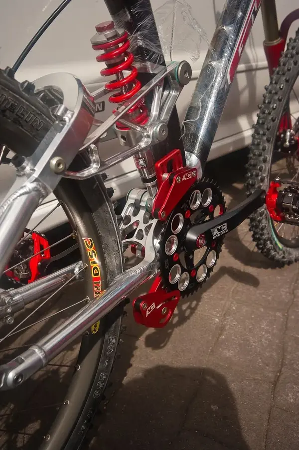

slowly getting sts lobo tarted up new decals (real gt ones not repros)
nearly time to assemble :-)

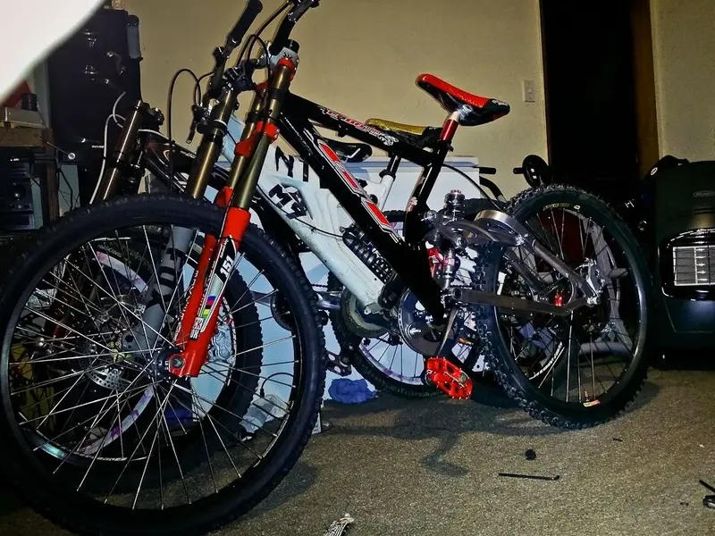

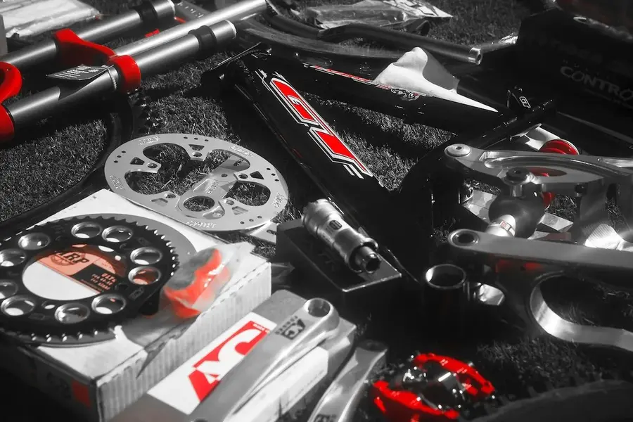

10 months into build and nearly done on one sts lobo :-)
not quite original parts but the bars rims and seat arent really bad parts to spec it with
( my old lobo had most of these parts )

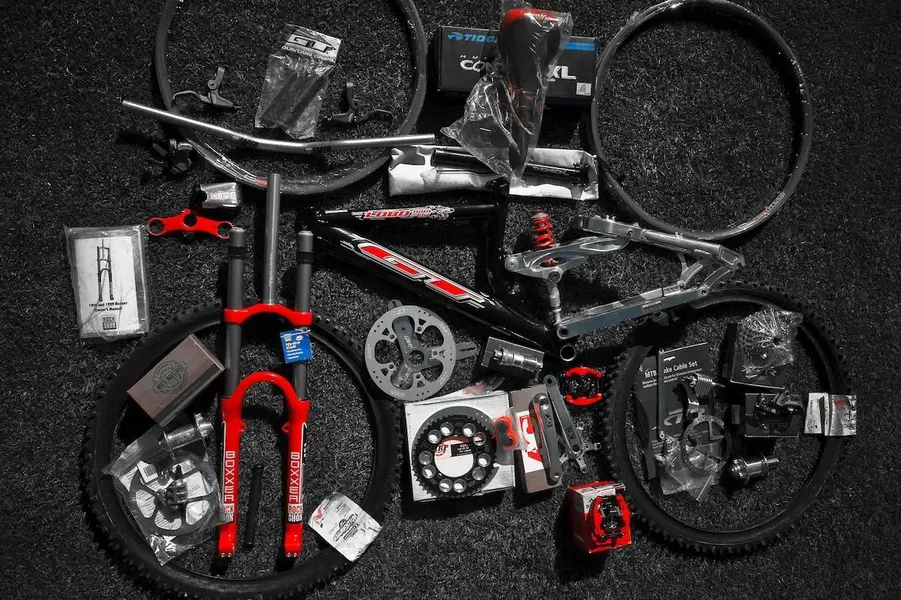

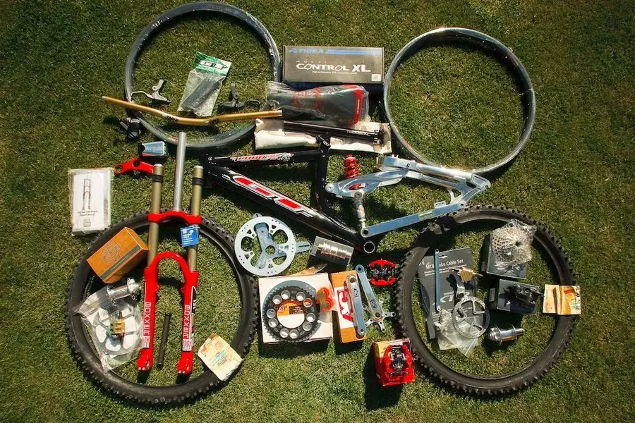

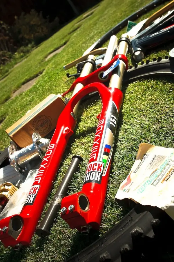

more NIB parts for the NOS 99 lobo (ok not right color but still NIB)

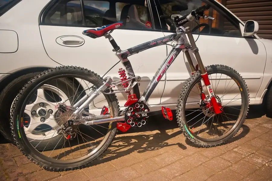

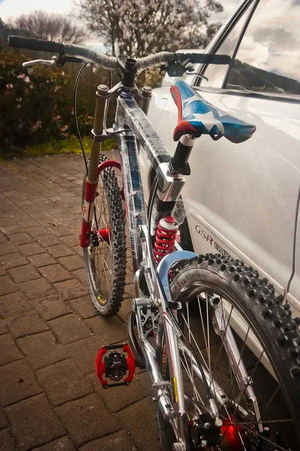

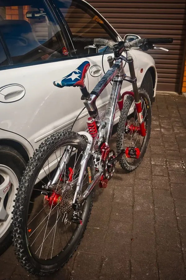

NOS lobo done :-)

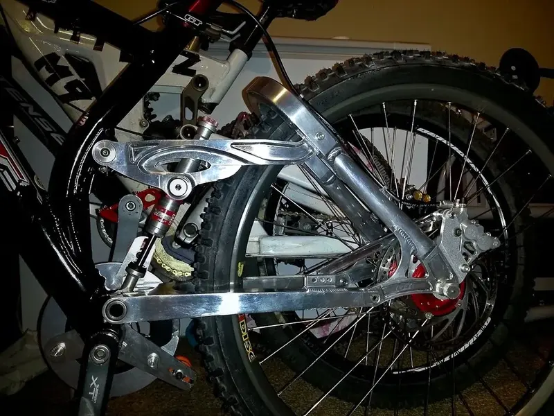

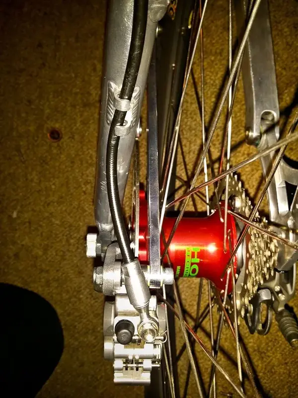

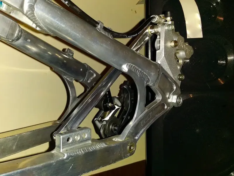

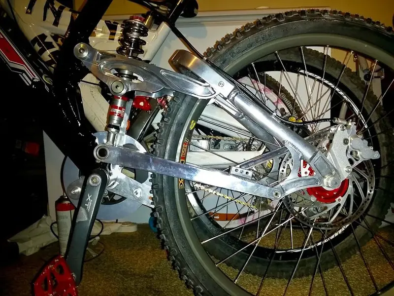

fitting rear brake to 99 lobo2
bolts to drop out is a good start
wheel fits and sits all good
filly compressed its all good
about 1.5mm clearence
sits pretty parallel to rotor and bushing good an firm
slowly getting there just need to get dee max rims laced to big un hubs
