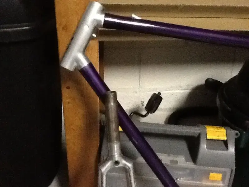

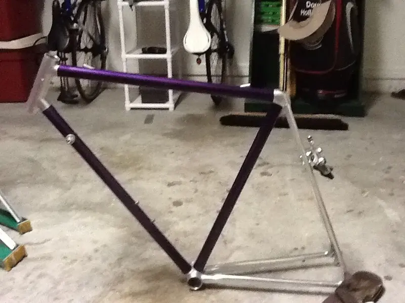

It was black anodized, but I couldn't afford the finish so I had a friend paint it candy purple paint. I can't find a Vitus fork, so I am probably going to add a black carbon fiber fork.

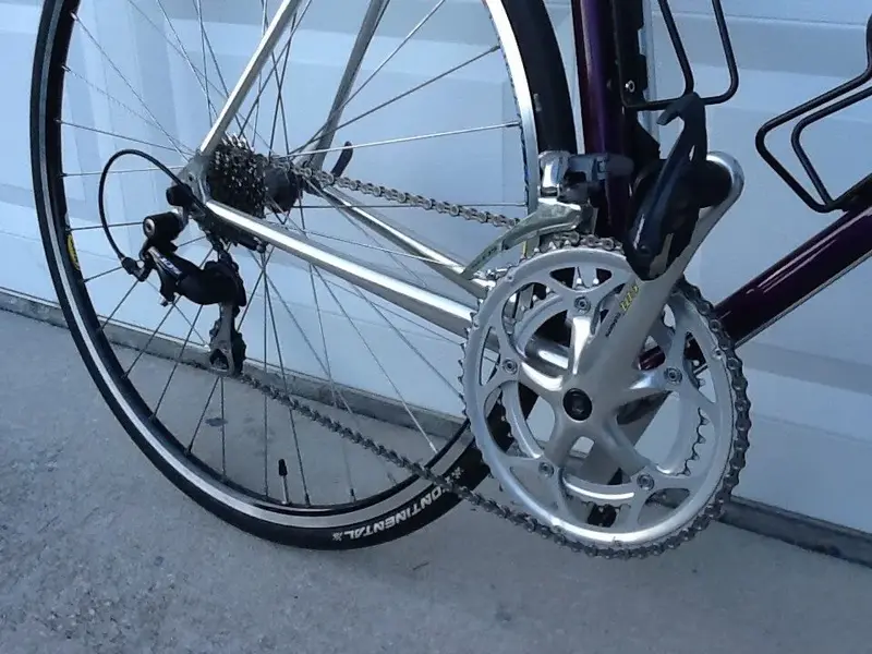

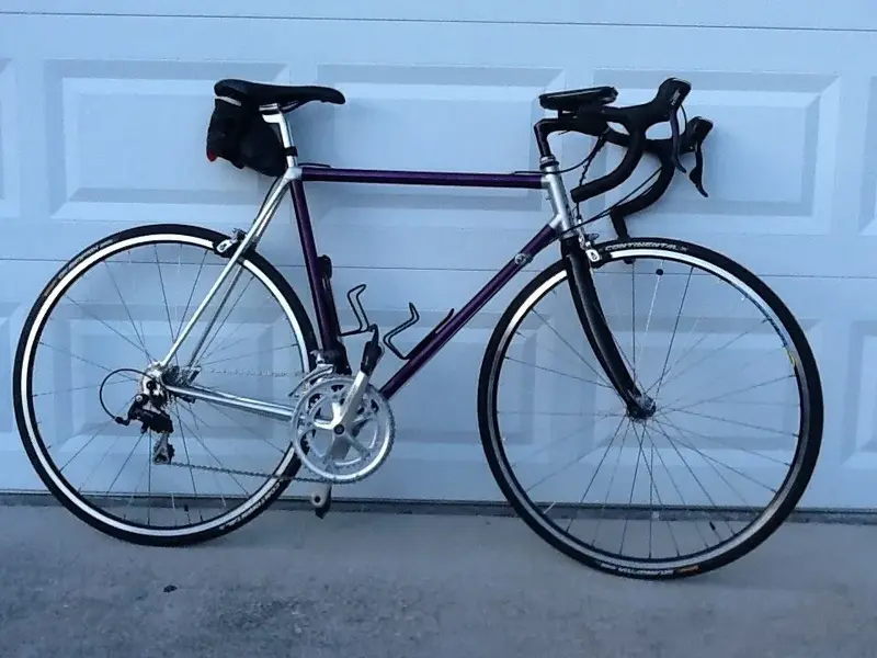

I finally finished the rebuild of a 979 Vitus. I went for a two hour ride and nothing fell off, so we did something right. I want to thank all the members and forums for the direction and suggestions.
