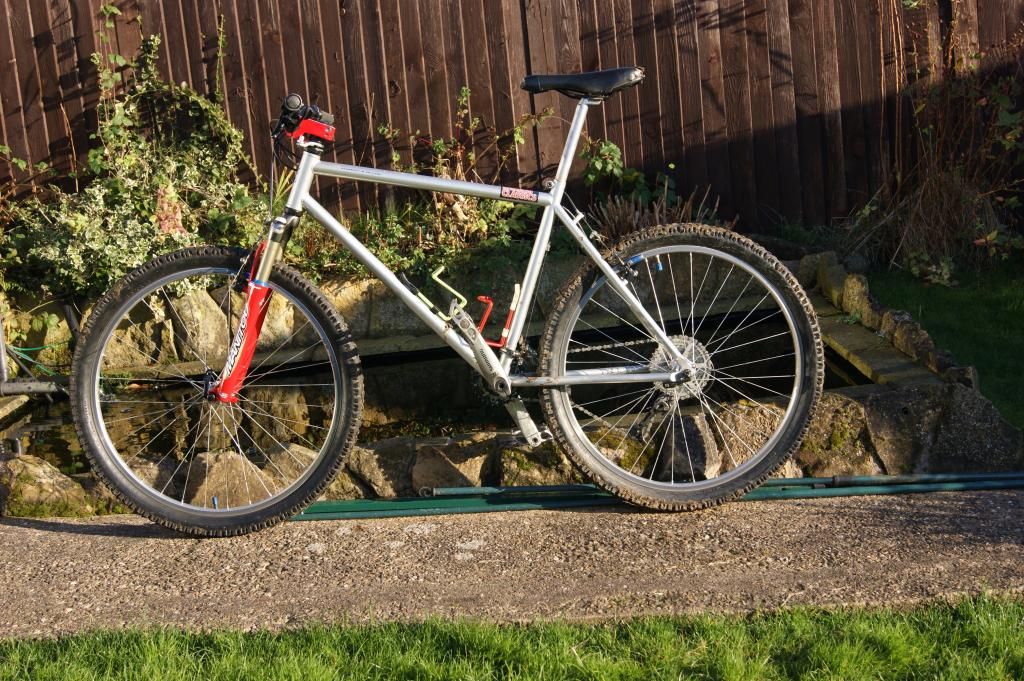

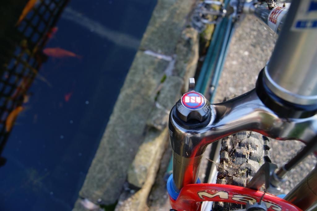

'97 saracen hardtrax 'pics with manitou mars on now'

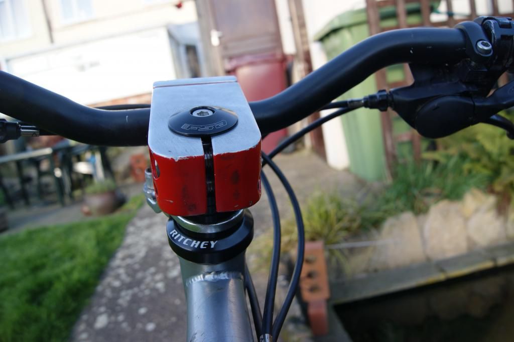

A free stem turned up :lol: it's steel and ugly but it's not too bad length wise and means I can use my 25.4 flat bars again.
Bar and stem weight has gone from 1055g to 476g :lol: Which more than cancels out the forks which means the whole bike is lighter :lol:
Rode it to work today - took 2 full cranks to get there 8) this is another job to the ones mentioned ^ there. Little bit more comitment round the corner and full pressure in the tyres should get it to no pedals I hope :lol:

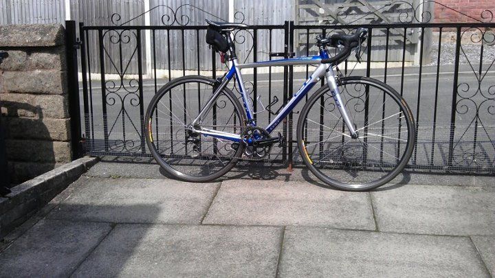

GT series 2 (alu/carbon road bike largely 105) -
Put on mudguards - got - done
Put on mech - getting off Santa
Put on lizard skins - (old bmx bar and frame pads I use on it when commuting to reduce damaging it - need to buy a chain stay one!) - put one on, couldn't find the other
Put on 25c gatorskin instead of 23c - got - mudguards doesnt allow enough room
Possibly raise bars if cables will allow - it won't
Another bottle cage - £5 - ordered
Put on reflectors
Maybe new bar tape -£20ish

my gt i spoke about earlier, excuse the baggage, was going to do a time trial and had to ride there and back :(

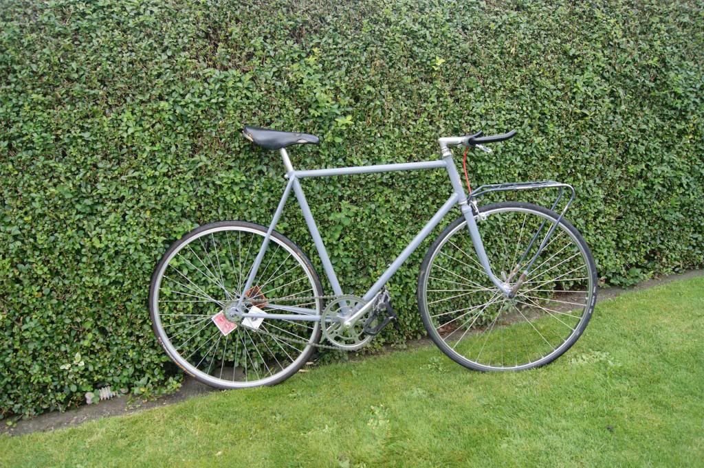

the puch i rebuilt with my dad, a very patina build, was odd not painting and polishing, simply cleaned, new rims, tyres, rim tapes, tubes, cables, brake pads, freewheel, chain and bar tape :lol:

this is with the new forks on but with the horrible heavy dirtjumper bars and stem on 'spits on floor' - deffo not for this bike!!!!!
this camera hides nothing!! doesnt look too pretty in this :cry:

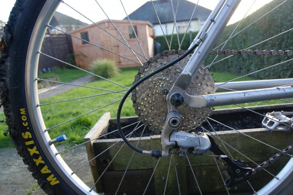

my huge cassette, 12-36, no hill is too steep with this 8)

Nice new forks man!

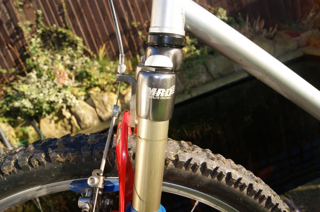

I'm wondering what to do about the canti hanger too. Can I slip it in among the headset stuff? haha.
Thinkin of Rockshox XC28 - pretty cheap, but with 100mm, travel. Plus an FSA pig bb headset.
Brakes are sorted now - got swiss stop rat pads on my cantis, so hopefully can keep em. :P
Actually - looking around, it seems you can't really use the stem cable hanger with suspension forks - cos it adjusts the length of the cable and means the brakes are ineffective.
Might have to swap to V-brakes for the front. :(
Got new tyres tho - Continental Mountain King II. Only 2.2 but look cool, fairly light and pretty inexpensive. :)
I did the same thing, hanger in the headset spacers then thought shit!! I was actually compressing the forks :oops: never gave it a thought!
Most forks have a hole that is or can be tapped to make a uside down L shape and drill + tap that to make it work like mine. It's actually a bit out of a door handle bent and drilled and tapped :wink:
The suspension is allowing me to go quite a bit faster, but now I'm feeling the need for 680mmish bars, which means going oversized - thinking cut down nukeproof bars in silver 8) or going for ritchey bars, cos if I get the Marin I'm after that's what I'll use :lol:
For the price (even cheap) you could buy much better period correct ones such as Marzocchi bombers which will work ten times better and are likely to last for years once the XC28s are pogoing in bike fork heaven.
