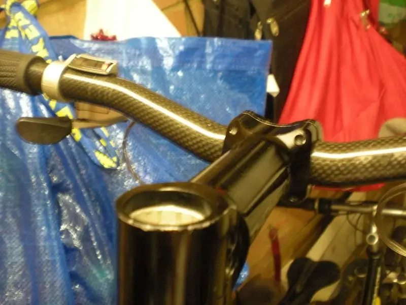

Was playing with the bike again and installed the headset. The steerer is a bit short TBH. With no spacers Ive got just enough for the clamp part on the Thomson stem. Steerer is about 10mm short of the top of the stem.
I'll get some pics up later. I think I need a different headset. The Thermo SP has a massive stack height. I also bought some 3mm spacers in rasta colours to go with the Salsa skewers, Id really like to use them.
What are the lowest stack headsets available? Im thinking the new Hope, or a King?
The stack height of the RF Thermo SP is 32mm. Ideally I'd like to find a headset with 10mm less stack height. This way I can use my spacers which amount to 9mm.
Some pics.
As you can see, without the spacers there is just enough steerer inside the stem clamp (bottom pic).
