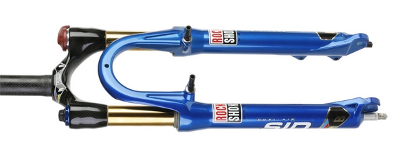

Hey Mike! yea will be watching this thread. Need idea,s for my cinder cone. Just wondering about the SID,s what weight are they? and how do they do against modern forks?
dave :cool:
dave :cool:
Nice one Dave. I'm really exited about this bike.
The SID's are among the lightest sus forks ever made, and highly tuneable. '98 SID's (the first ones) have 63mm travel while the ones after that have adjustable travel between 63mm and 80mm. They aint the stiffest in the world though so probably not good for heavy riders. Going by your avatar you don't look like a massive bloke so you should be OK. If your going for older SID's try to find a pair that have been recently serviced. Otherwise be aware that if abused and not looked after a SID can end up with damaged inside walls where the air piston slides. If this inside wall is scratched the fork wont hold air pressure. TF tuned do a seal kit though and its no that difficult to strip them down and clean everthing up then fit new seals. Pre year 2000 SID's seem to go pretty cheap but you could end up paying a fair bit for a service to get them running like new again, unless your pretty good with the tool kit and can do it yourself. If you want to run disks you will need a >1999 version. The '98's didnt have disk mount. I've got '98 SID's but I'm getting some NOS '99 lowers for them. You can upgrade the stanchion seals with the latest Rockshox seals too. Probably a good idea with UK conditions.
Against modern forks I would expect them to hold their own if well looked after and set up properly - negative spring pressure is critical to overcome the inherent friction in air sprung forks. Maybe not as stiff as something like a Marzocchi or a FOX though. If your into anything heavier than XC id stay away from SID's. I like to occasionaly get airbourne (who dosent) but nothing hardcore. I just like fast fun technical XC riding. I reckon SID's are OK for this if set up plush. Look at what they were designed for, hard charging XC racing. They must be fairly tough to withstand that. Just my opinions though, others may think different.
bigdavevw":2t391yvd said:
Awesome!! good reply there :D I,d buy them just for the lovely blue colour :LOL: :cool:
Check these out then!
2002 SID Race Ti
2002 SID World Cup Ti
Both had a deeper shiner shade of blue and Ti Nitride coated stanchions. Sexy . :cool:
I could have had a mint '02 Race Ti (eBay) for this build but I ran out of dosh and mised out :cry: They sold for £102 with only one bidder but I had just ran out of cash at the time the auction ended :cry: :cry:
