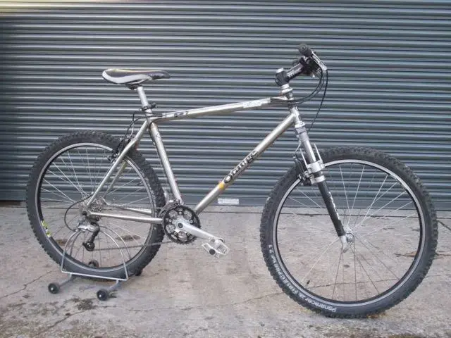

My original purchase.

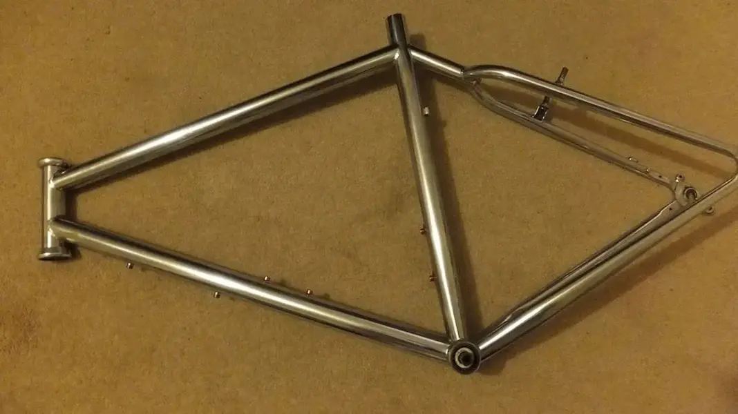

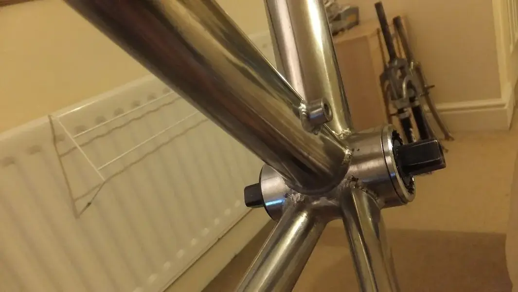

Chemically stripped, sanded, polished and raw.

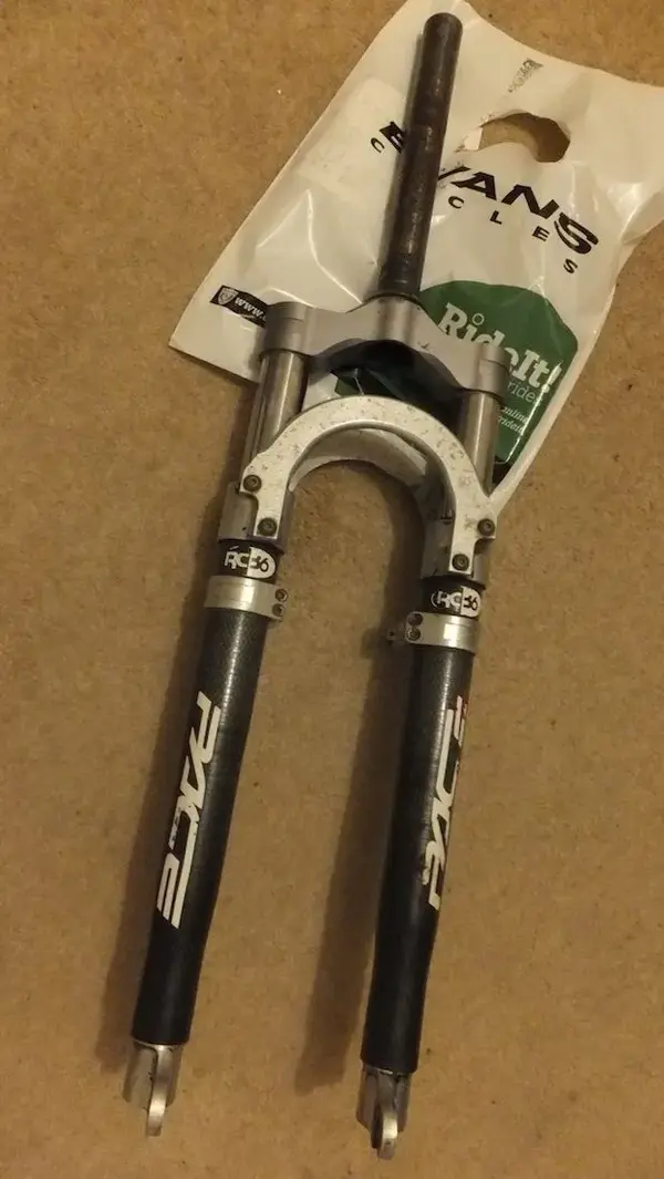

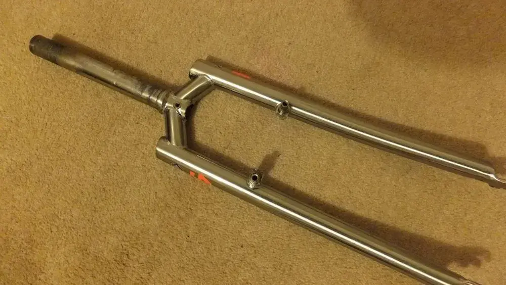

So, the first question is: I've gone and bought some F7 forks from a nice man on Retrobike which would work perfectly, but then again, the RC36's do look pretty good.
Which would work best on the rebuild? Originally thought I could just pick and choose depending on the type of riding, but then realised each fork takes a different headset, threaded and unthreaded, so I have to decide before going any further. Decisions!

That sure is a nice shiny P7 frame :cool: Are you keeping it in the raw or gonna clear lacquer over?
I'd recommend those equally shiny F7s for an uncluttered classy consistent polished scheme overall.

Very impressed with your polishing. If the bike were mine, I'd probably go with the rigid fork, since I like the simplicity, lower weight and zero maintenance. Good luck with your rebuild though, whichever fork you decide to use. I'm sure it will turn out stunning!

Question about the F7 rigid fork option: With the crown of the forks being much lower, it will alter the geometry and riding position of the bike. Has anybody here swapped suspension for rigid and found the front end too low??

I'm going with rc36 proclass forks rather than the F7's will watch your build with interest.
The geometry in the 1st photo with the Pace forks looks too high at the front and odd. The P7 was marketed with F7s as the intended fork. The geometry of the P7/F7 set up will work just fine as originally intended and will also look much better. But it's what feels best to you in the end.

I too would go with the F7 fork. They are pretty forgiving anyway. Geometry will be good with the f7. You can always change your mind if you don't like it :D

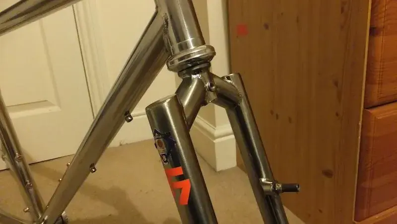

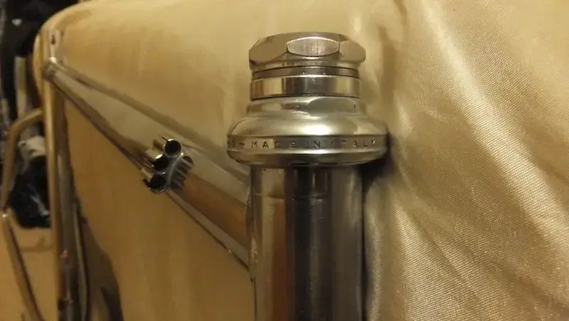

The consensus of replies was for the classic F7's for a very chromey P7 look. I had an old Azzurri 1 inch headset, originally made for a road bike, but a headset is a headset right. It fits my steerer and makes everything that bit more silver. LBS fitted a headset for me and trimmed the steerer.

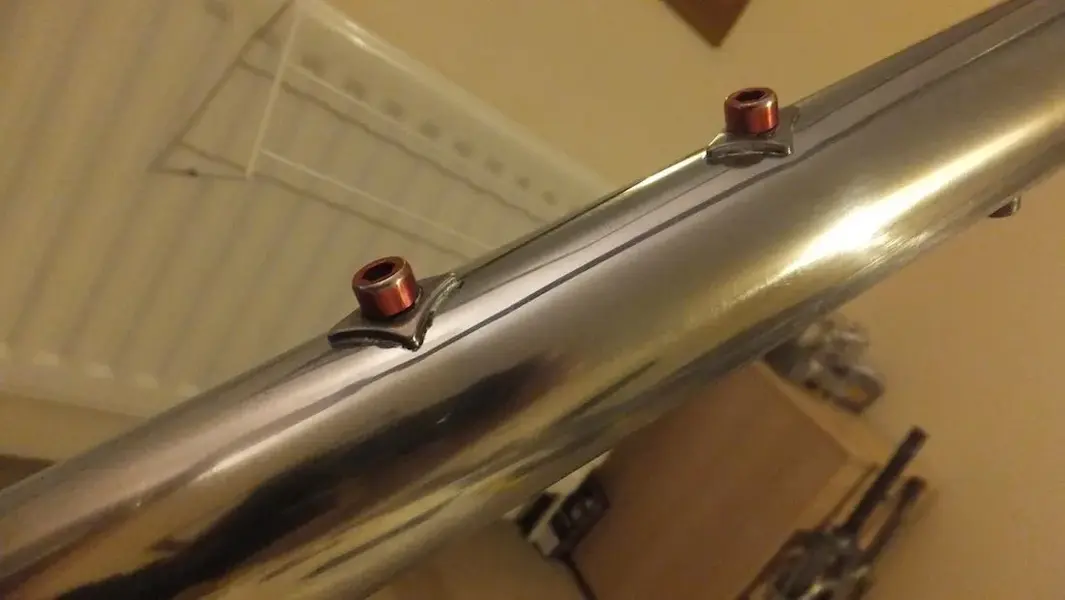

I've decided to follow the route of many a P7 restorer and just leave as polished chrome, not sure the expense of trying to get it all re-lacquered would have been worth it. I'm the sort of cyclist who actually likes taking bikes apart after every ride to clean the components individually. Well . . . it's a hobby!
New cranks, old cranks
And just installed bottom bracket and cranks, although had to run down to LBS to buy the damn "external bottom bracket installation" tool. Why is there a new tool needed for every new part these days? Decided not to invest in a torque wrench, just got the crank nuts 'arm' tight - will re-check next time I polish.
