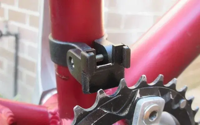

A period correct (!) light mount was modded to serve as a chain guide, so I could get rid of the front derailleur as well. It still needs a bash guard to stop the chain falling off the other side though.

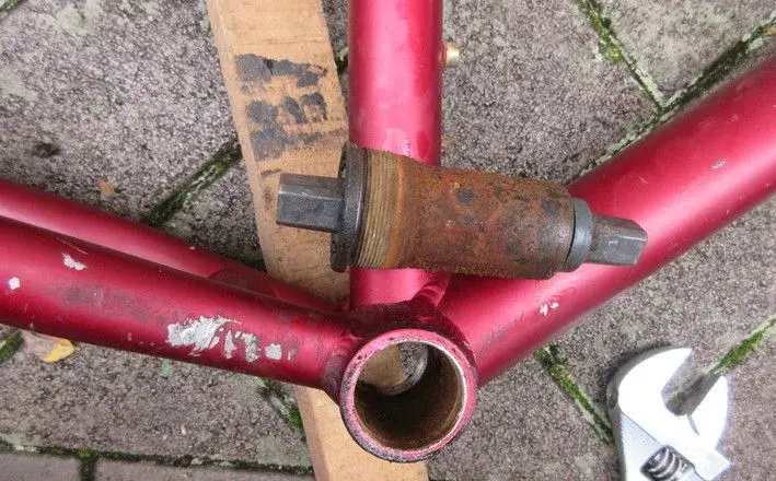

Nice. I'm quite into a bit of budget bodge retromodding too, so will be interested to see how the Kona goes. I'm liking the period correct light mount reimagined as a chain guide – I'm running a single ring on a modded 'Sugino-alike' cheap crank and would love to ditch the front derailleur and everything that goes with it but have been wondering how to keep the chain from flying off at the worse moment, without spending a fortune. That BB has seen better days – dread to think what state mine is in. Good luck with the build.
