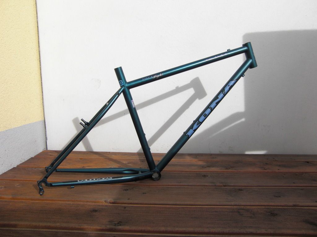

I found an old pic. of my 18" Kilauea on the scales
And a pic. from the driveside
At the first pic. on the scale you can also compare the chainstay design.

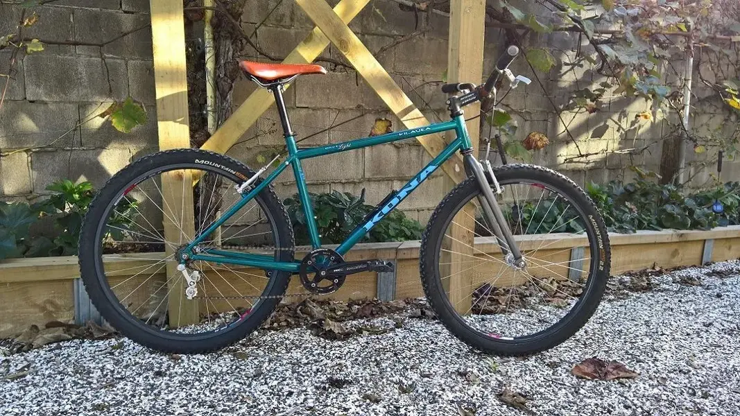

After stripping down the frame was 1940gms so with that, the diameter of the top tube and the overspray in the bottom bracket tube being turquoise I decided to getting some kila decals off Gil_m and respray trying to match the colour out of the swatch book.
here's how shes looking now...
In the mean time I have brought a 96 explosif frame off ebay ....so the velocity stem and tb p2 forks will be going on that this will stay as is.

Re: Unidentified Kona Frame - 96 Explosif/Kili?
That's a really nice job.
Great save and researchers.

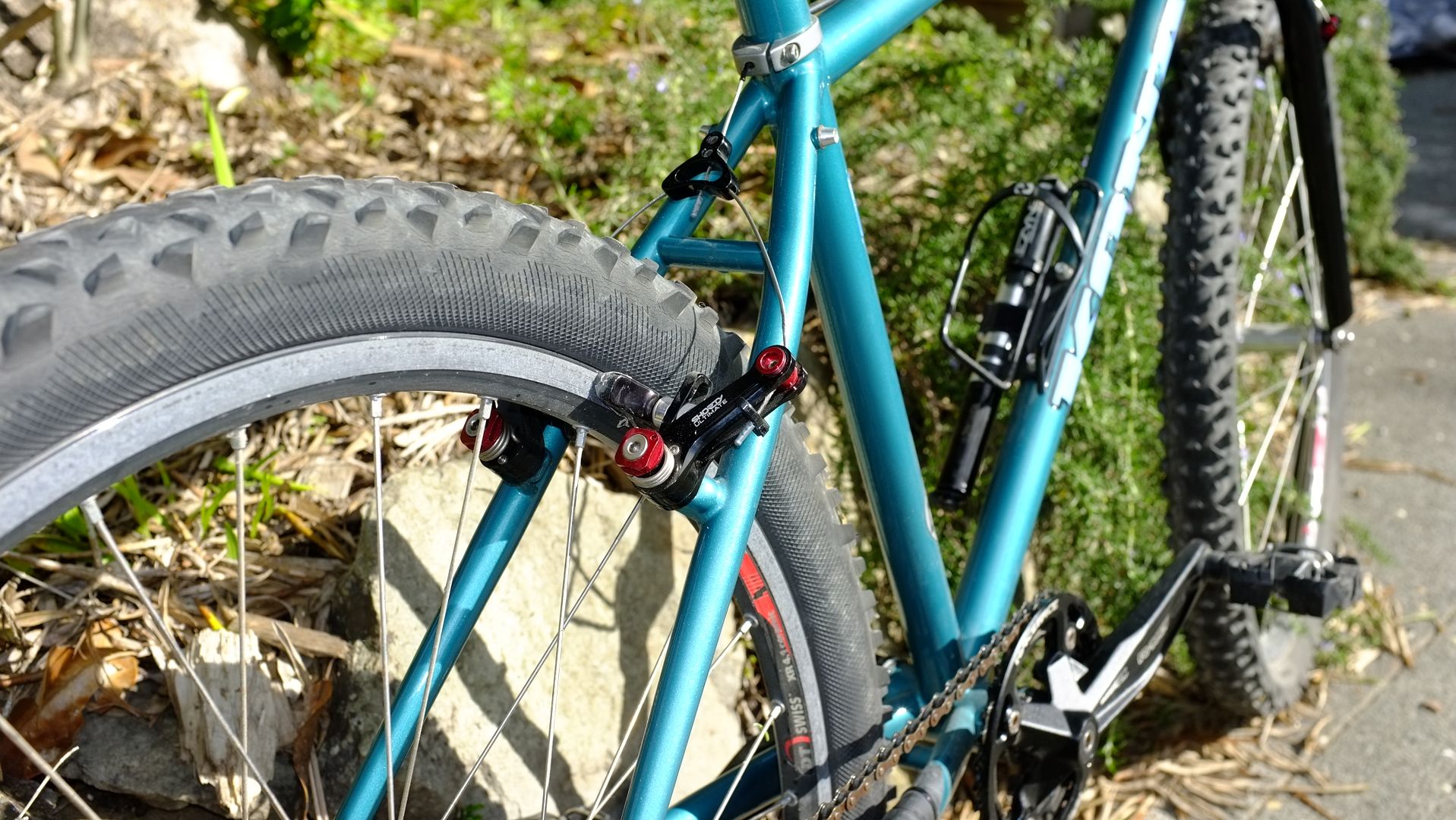

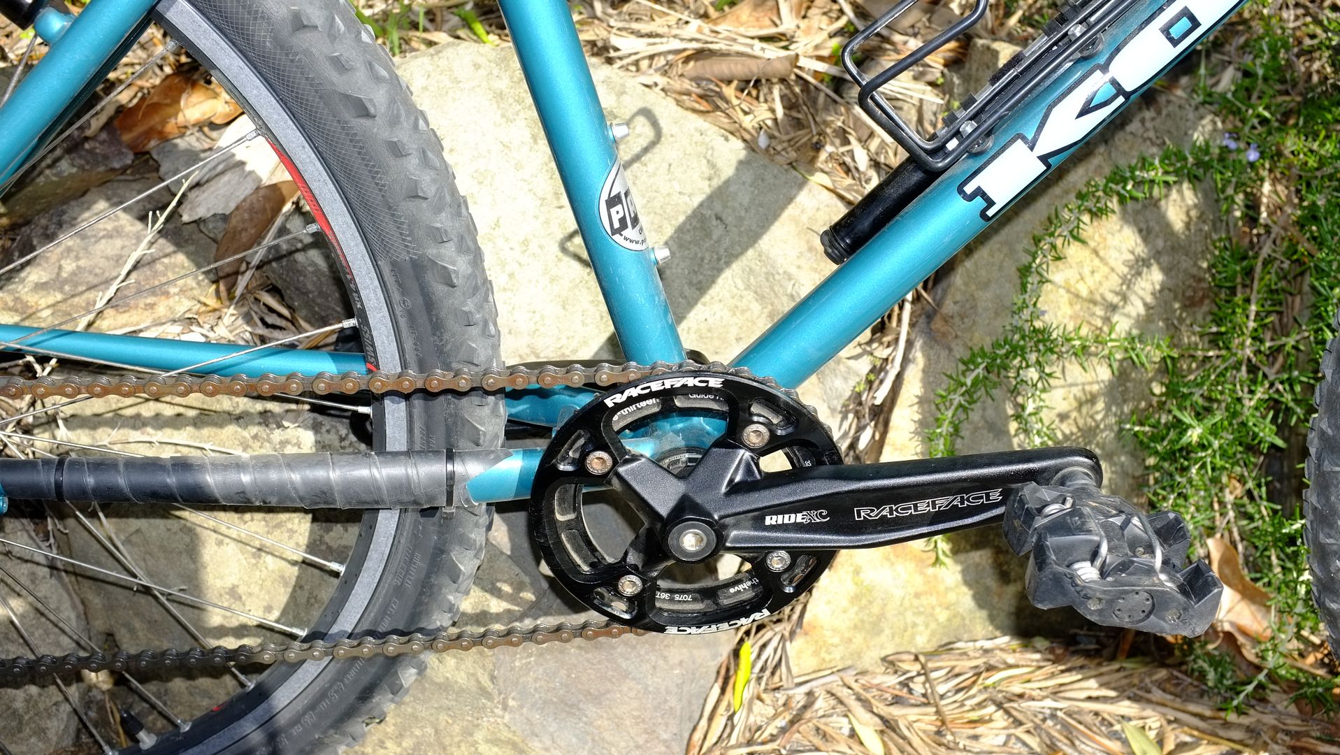

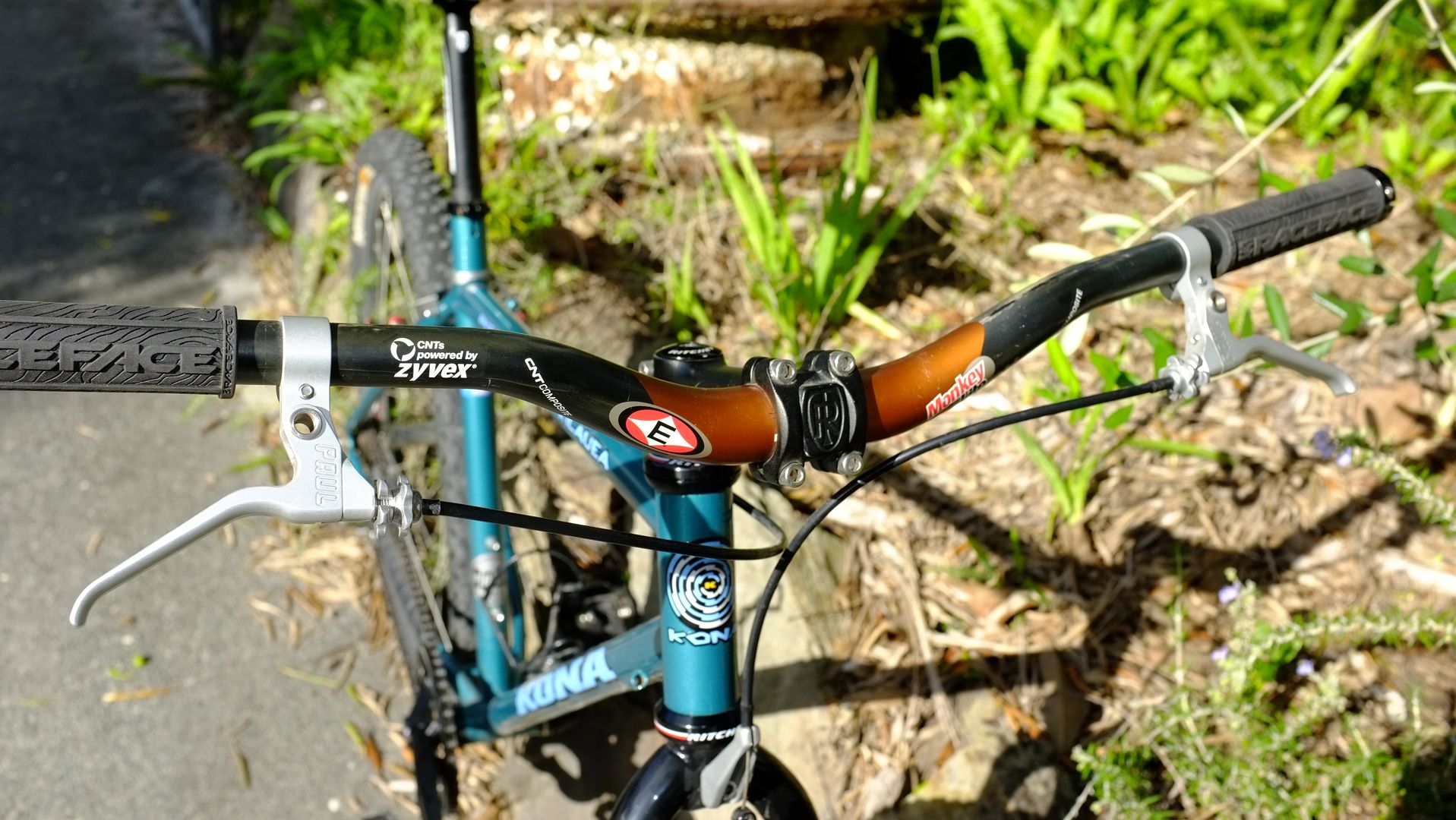

Have made a couple of changes to the Kilauea.
Frame: 96 Kona Kilauea
Fork: Kona P2
Headset: Ritchey Pro
Stem: Ritchey
Handlebar: Easton Monkey Lite
Grips: Race Face Half Nelson
Brakes: Avid Shorty Ultimates
Brake Levers: Paul
Cranks: Race Face RideXC
Pedals: Time
Rims: DT Swiss
Hubs: Paul
Tyres: Continental Mountain King
Saddle: Brooks B17
Seatpost: Ritchey Comp
Seatpost Binder: Kona
Preferred the tan/orange saddle but otherwise really like this single speed Kona with the respray colour. Also really like Magas' lovely green gummy tyred Kona too. Very nice work chaps! Always lusted after a Kona but never got round to one.
