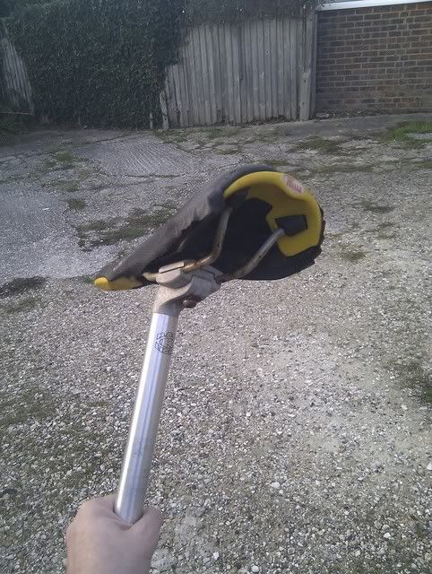

rescued seat post and very worn out seat
The seat post looks original, but I'm afraid that saddle isn't. It's similar to the type they used in 1997 actually.
For reference, this is the type of saddle they used in 1995.
http://cgi.ebay.co.uk/ws/eBayISAPI.dll? ... MEWAX%3AIT
The price is surprisingly high, but you can see why I suggested you go back and get the original saddle from him if you could!
Alas Anthony, no saddle love from the crazy man in the shop.
