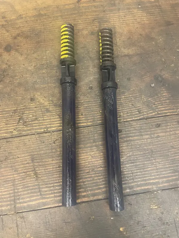

I’ve just found a pair of Type 2 elastomers/springs which were from a pair of Indy’s.
Anyone know if they are same diameter and whether they are compatible with Judys? They are longer by around 2-3cm than the Judy ones so I would need to take a bit off the elastomer.

I ended up using some type 2 Indy internals which have worked well and they feel nice and firm.
