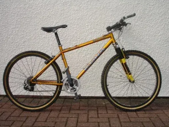

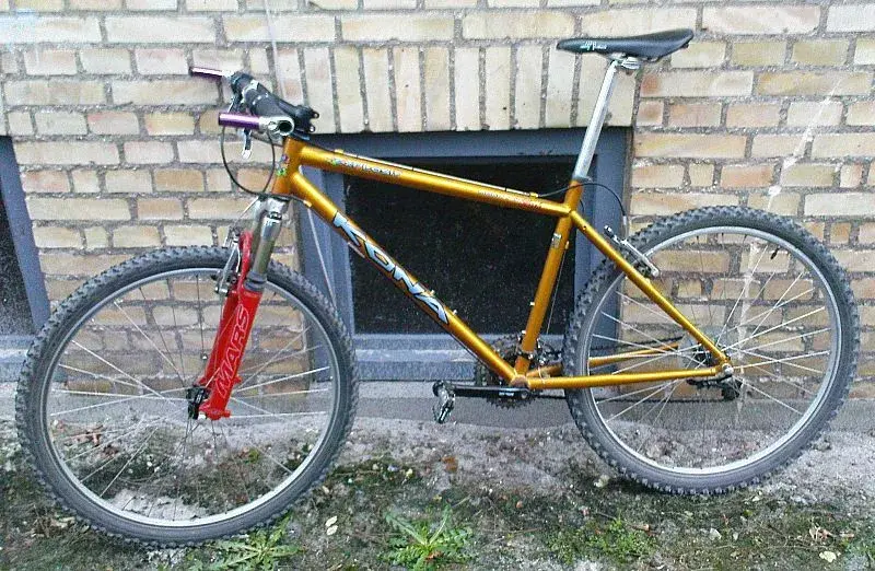

Here are two Explosifs, one of which you might recognise Trevor. Note they have the same head tube and note the different lines of the top tube and the different lines of the seat stay clearly differentiating between your 17 and 18 with the Mars forks.
I trust this is a definitive answer, on ye of little faith?
