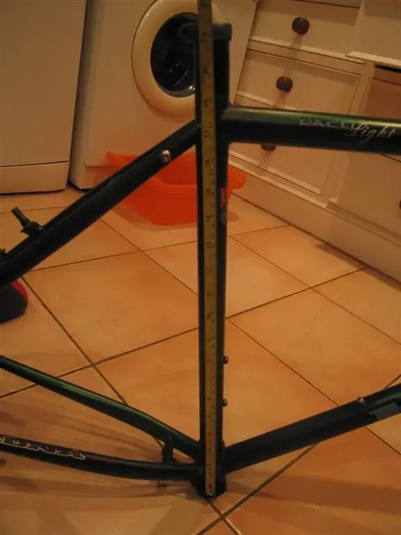

Just found this from a couple of weeks ago. A 96 lava dome, 19inch frame. Looking at the tape measure it reads 20inches B/B to top of seat tube making it a 19inch. The seller for the 94 lavadome says the same measurement on his frame from the bottom of the B/B was 19 1/2 inches. Move that measurement to the centre of the B/B taking off half an inch making it 19inches B/B to top of seat tube. This would make the 94 bike a 18inch frame. I have asked the seller to measure the headtube and he says he is 5'6'' tall, a bit short for a 19inch IMO! Any thoughts or corrections?

Seller says head tube is 130mm. That makes it an 18inch frame, doesn't it?
The measurements this chap have given you make this frame 18", yes that's correct.

Head tube lengths changed (became shorter relative to frame size) when the geometry went suspension-corrected in '94. My '94 20" Kilauea has a 150mm head tube. The 19" '96 Explosif currently for sale on eBay has a 130mm head tube (I asked).
Centre-to-top gives the frame size (in inches) - the seat collar and Pythagoras can add a few mm. So a frame that measures 18" centre to top is an 18" frame, not a 19" frame. Yours is a 21" frame. They were made - see the geometry table here, for example:
http://www.konaretro.com/articles/catal ... 2Page8.jpg
No, that's a 20".
