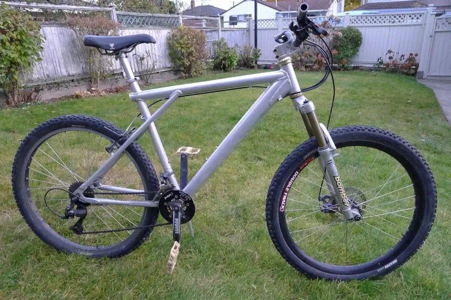

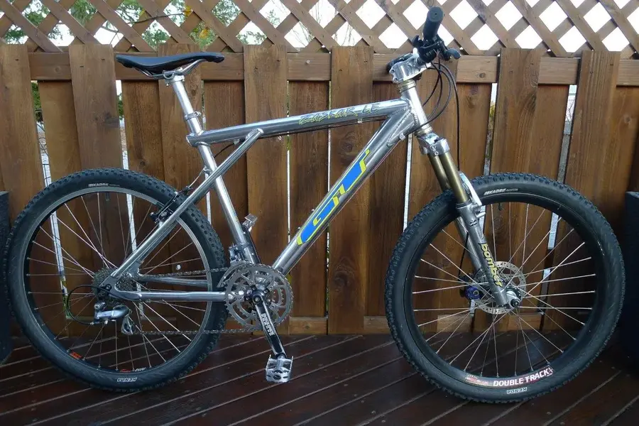

I recently finished a 96 Zaskar refurbish. I had used this polishing technique found somewhere on the interweb for polishing parts and decided it would work just as well polishing a complete frame. I start with an SOS pad along with taking any grease off and then focus on any bad scratches with a fine file or 180 weight sand paper, once the frame ready I sand and wet/sand using 600 grit sandpaper followed by 1000 and then 1500 grit wet/dry. You can keep going if you need it even more polished but this level is fine for me. I usually lightly polish it a bit with hot water and a new SOS pad and then move on to using SIMICHROME polish and cotton balls. It's a lot of work but worth it. Here is my before and after:
