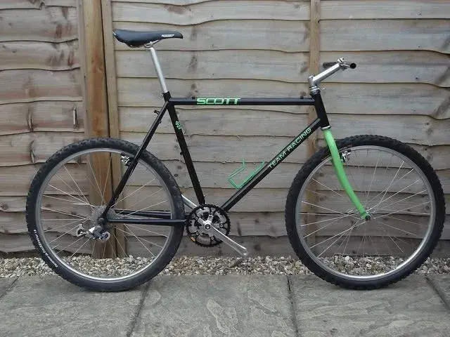

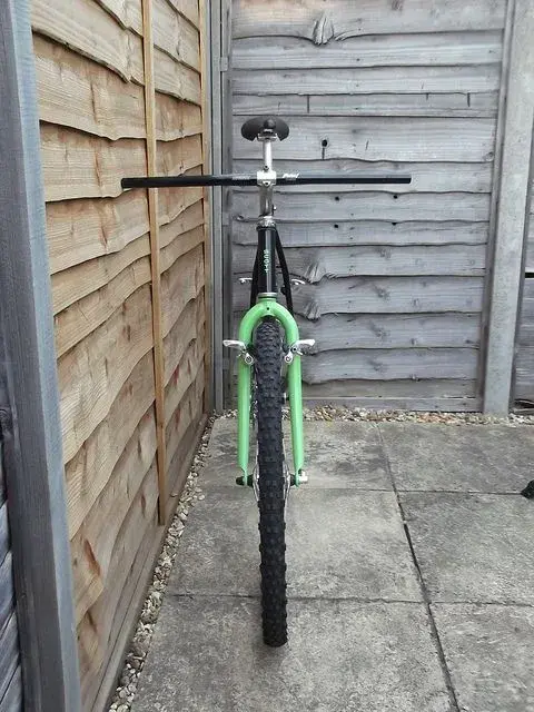

Update part 2 !
Awaiting delivery of a stem and grips now , and still looking for a seat post , prefferably a silver Ritchey one , but thought I'd post a couple of pics with 26.0 post and temporary stem to give y'all an idea what she is gonna look like . Ta da !
Kinda cool I'm tinkin' 8)

Re: '93 Scott Team Racing is reborn
Thanks mate ,
I think it's coming together well . Can't wait to get it together now ,
least of all because my only other mtb is up for sale on this forum :(
Any luck with bar choice on the Superlight yet ?
Mike
Hiya mike, liking the look of your build , although surly that Shimano Xt 739 rear mech is going to be replaced with a short cage 735 ? :lol:
Are you going for thumb shifters for the changing duties ?
Like the cranks :) I'm just about to go through the last few grades of wet n dry then polish the suckers up :P
Cant help but think black ritchey brakes would work better with that waitrose green you've got going on there though :)
