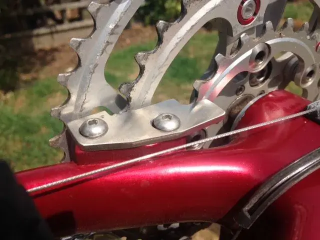

the cassette is on!
As is the Stainless chainsuck plate I added before mayhem, and the neoprene chainstay protector - this is a bike for riding!

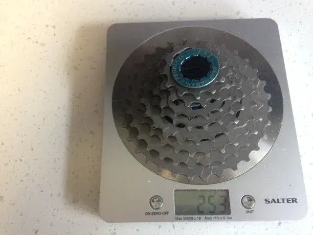

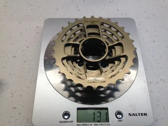

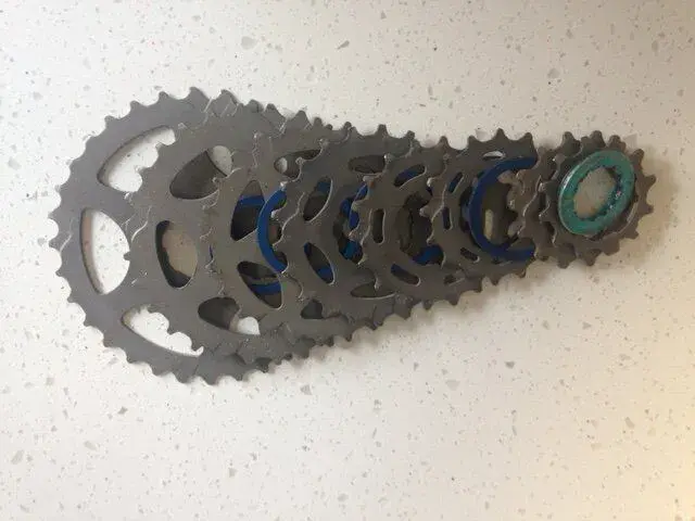

Weighed all of the cassettes too;
Tioga/srp Ti;
Shimano m737-1;
Goldtec;
Full Spec;
