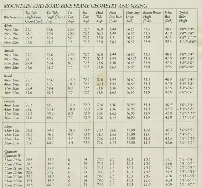

I am thinking 110mm or 120mm w a 22.5in handlebar. Kleins were sized in inches measured center of bb to top of seat tube. Which size is your Rascal?
It's an 18" which according to the 93 catalogue was the smallest size, I'll be going with a 100mm stem and a 600mm bar to start with as that's what I have laying about. 👍 _20230830_210229.webp
It has a 22in effective top tube w/ a 72.5 seat angle. Your medium Bonty has a 22.6in top tube w/ a 74 seat angle... it has way more front center. You will need a longer stem on the Klein than on the Bonty.
I believe the Klein will be good on technical, steep, slow singletrack. Slow speed balance and control.
I've just done some measuring and it doesn't correspond to that chart at all!
Has a 46cm seat tube but a 592ish effective top tube. God knows what's going on there but it will be getting a shorter stem.
It's probably a tad too big but I'll give it a go, don't know till I try.
Wheelbase length tells the story ime. Since cstays don´t change, front center length sets the size.
