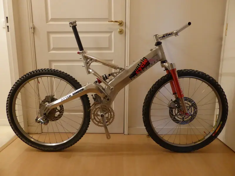

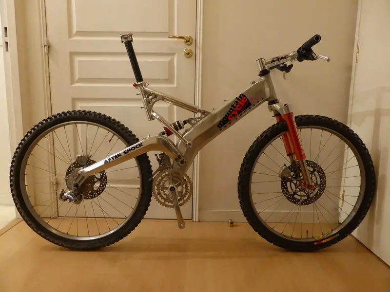

'92 Mountain Cycle San Andreas resurrection

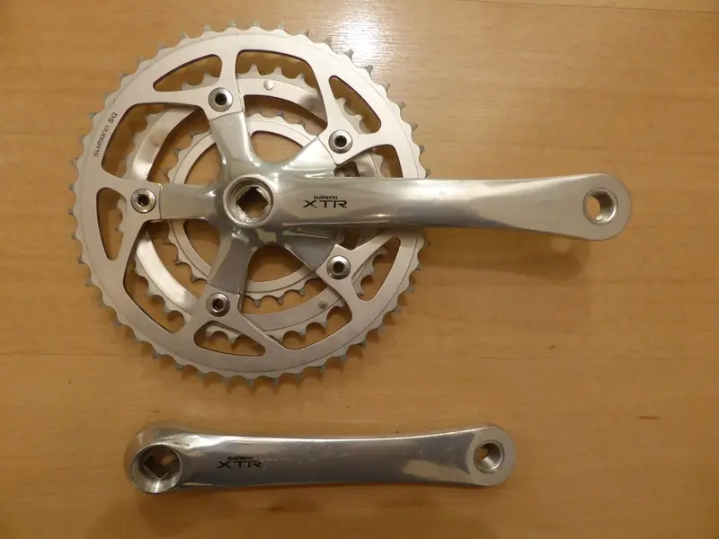

A nice FC-M900 175mm crankset and NOS CN-7401 chain were located in a reasonable time.

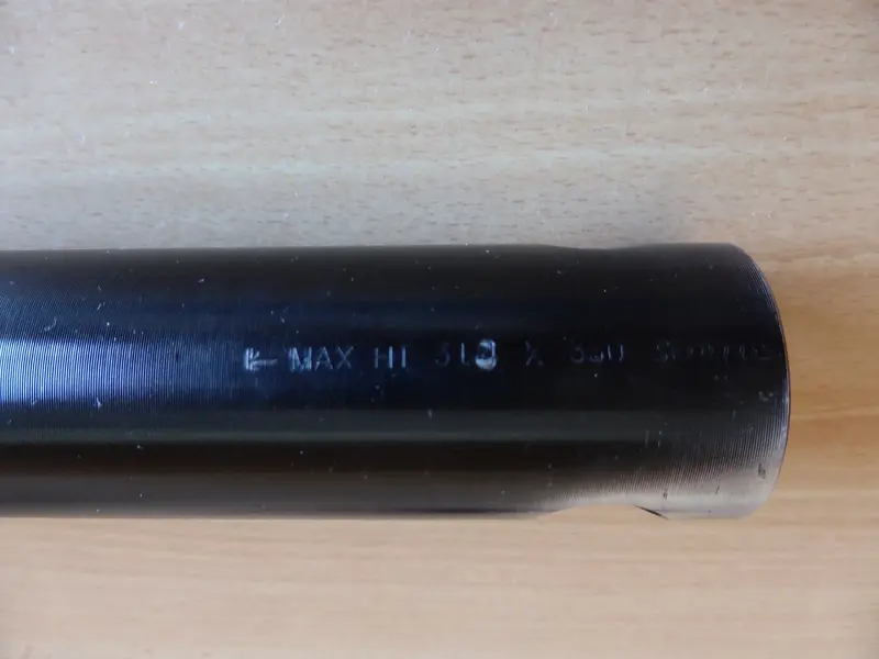

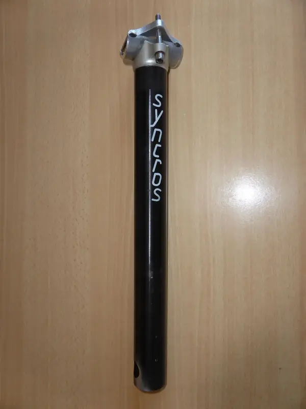

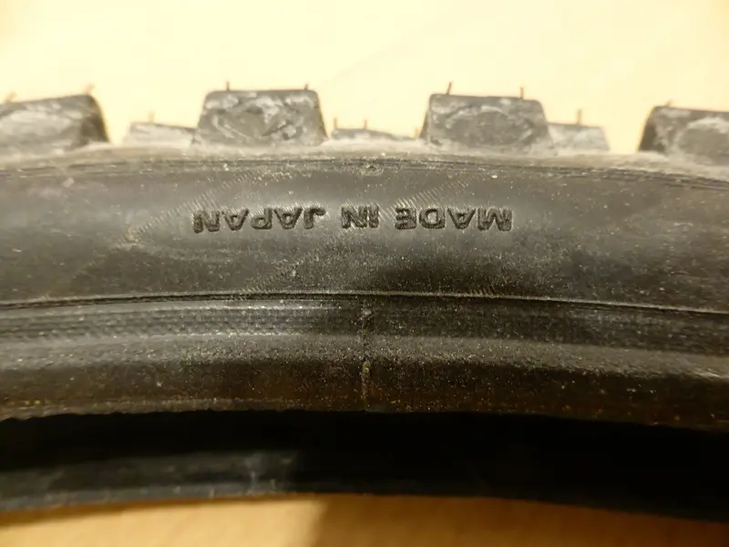

So were front FD-M900 31.8mm and rear RD-M900 derailleurs. But after months of unsuccessful hunting trying to gather the remaining bits, it became obvious to me that finding a Syncros bottom bracket in correct size, an uncut 7075 T78 Syncros Flatbar handlebar, a 2nd gen. Syncros Propost Ti seatpost and an Odyssey SveLte Hi-Performance saddle with titanium rails won't be easy. Not even talking about finding a pair of rideable onZa Racing Porc's Kevlar tyres...
Since plan has changed, putting back the Cook's Quality Products (CQP) crankset, a popular choice among the racers BITD (with its Cook Bros. counterpart), was considered.
On the one side, it's a cool no-more-seen-that-often bit of hardware. On the other side, with its roots into the BMX scene of the late 80's, it already was an outdated component in 1992, featuring e.g. a strange notch in the drive side crank to accommodate for the front derailleur clearance, something clearly revealing overlooked engineering.
Additionally, the shape of the drive side crank doesn't allow installing a big ring with an anti-chainsuck pin.
Lastly, it requires a spindle with a particular longer square taper, not conforming to neither "standard JIS" nor ISO spindle (below picture taken from [1], no more available online).
Sure, you can fit it on a shorter "standard JIS" or even ISO spindle, but the spindle/crank interface is then far from ideal. Believe me, I had the opportunity to fit my crankset on a genuine (but unfortunately too short in 122mm length) Cook Bros. spindle with the correct longer square taper, and the difference at the spindle/crank interface was obvious. Plus I've heard horror stories of people having cracked their Cook Bros. cranksets, probably because they were fitted to unsuitable spindles and over-tightened. All this made me stick with the XTR crankset, more geared towards the future, as was the San Andreas BTW.

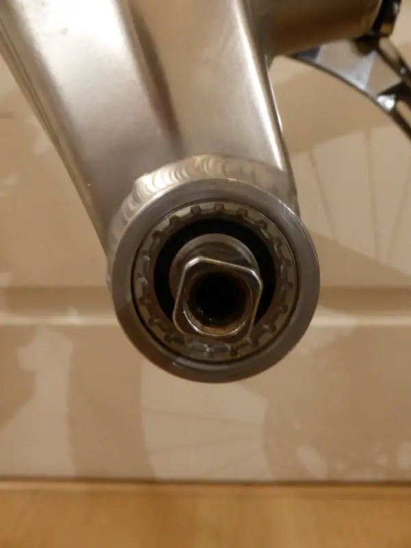

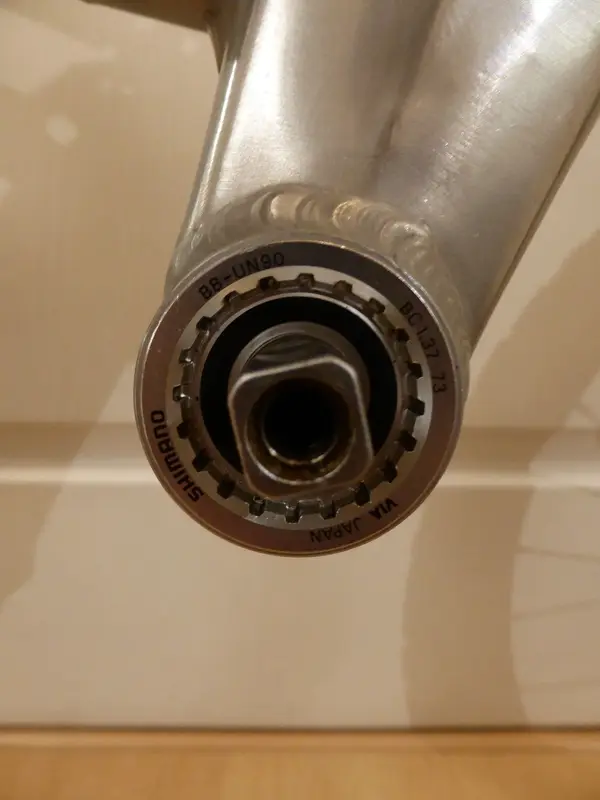

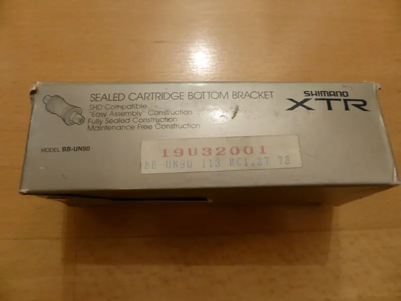

Securing a suitable BB-UN90 73 x 113mm bottom bracket to achieve the 49-50mm chainline, as spec'd in Mountain Cycle 97-98 Product Collection catalogue [1], was time-consuming. Sure, 97-98 may seem too recent w.r.t. my '92 San Andreas. But (i) I couldn't find an older Mountain Cycle catalogue with this information and (ii) the San Andreas frame remained largely unchanged over the years.
I nevertheless tried a shorter 73 x 107mm bottom bracket and the chain was noisily rattling when set on the granny gear and the biggest sprocket of the installed CS-M900-8Q 12-28 cogs cassette.

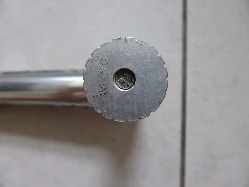

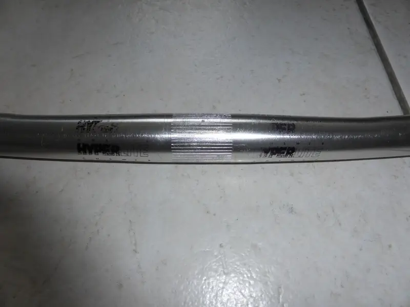

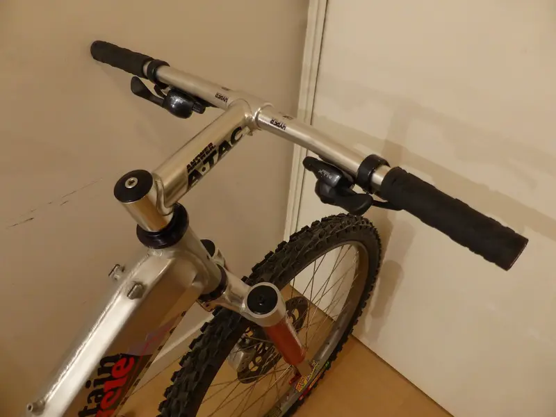

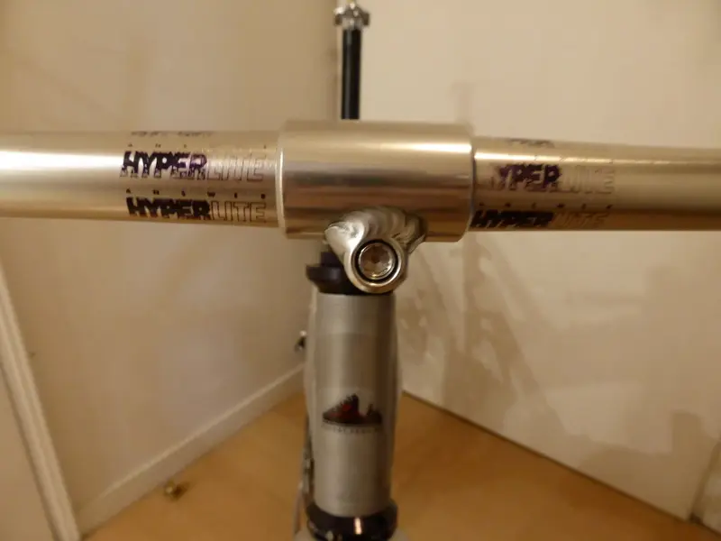

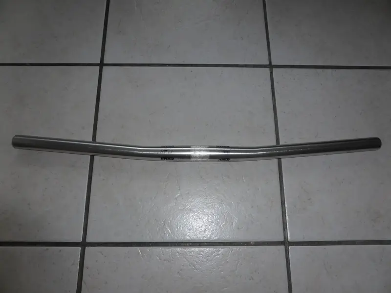

As on @Baulz bike, I was able to put my hands on an uncut Answer Hyperlite 5 degree handlebar.

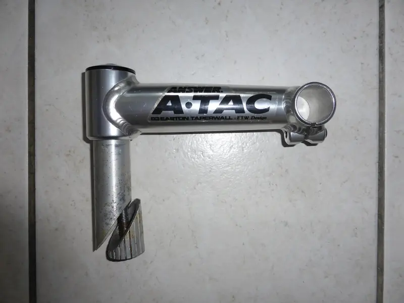

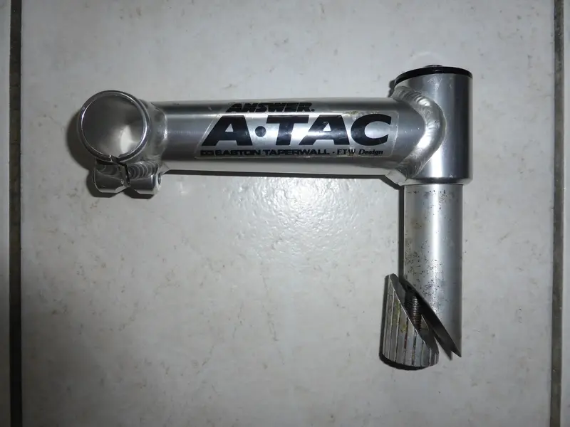

However, I didn't like how the Syncros stem was partly covering the Answer Hyperlite writing, due to the large clamping area.

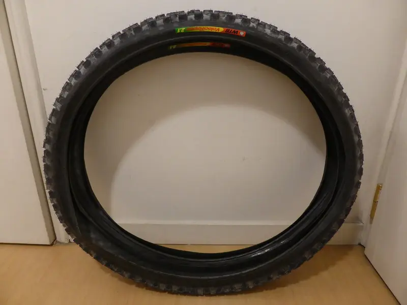

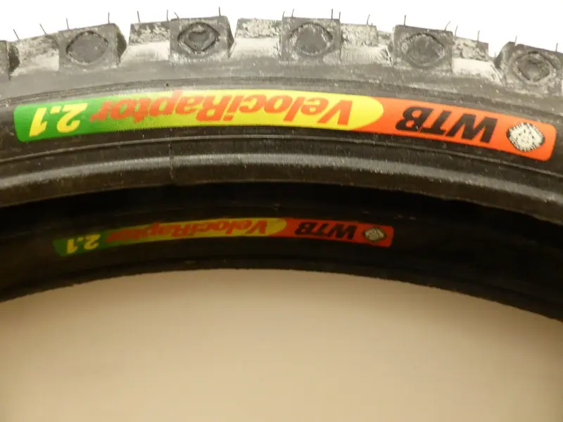

A pair of period-correct (well, I thought...) NOS WTB Velociraptor completed the initial rebuild.
At the time, I wasn't aware that the Hyperlite handlebar had to be installed the "reversed" way in order to be able to read the 5 degree writing from the cockpit :p.

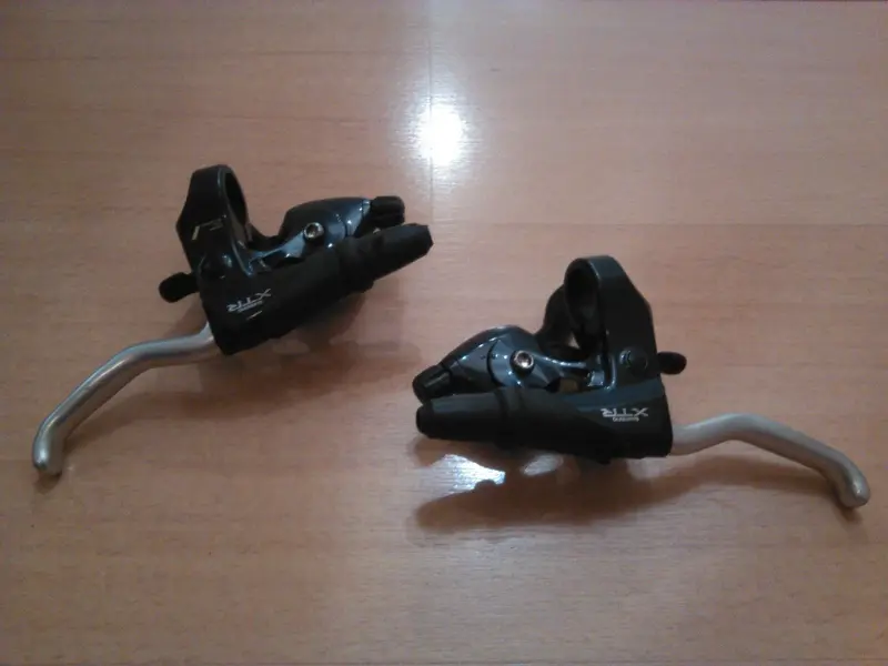

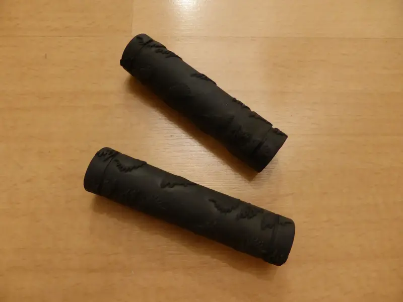

A set of ST-M900 shifters/brake levers combos in great condition shortly followed, accompanied with a pair of used (and unfortunately cut at the ends) black onZa Porcipaws handlebar grips I had lying around.

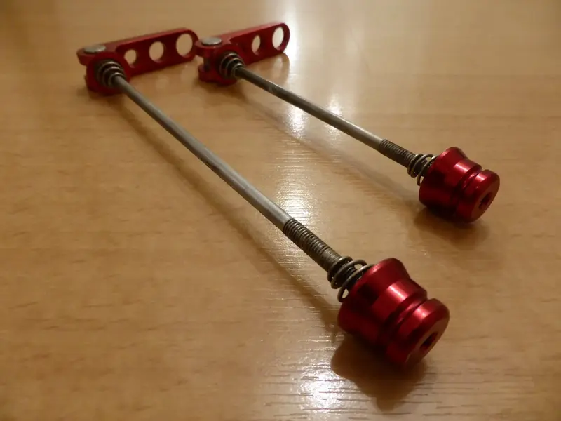

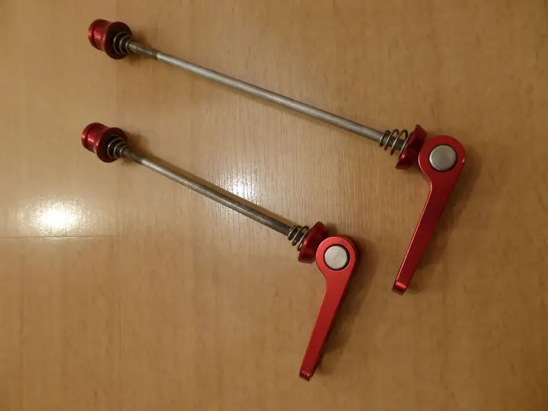

Matching the red anodized Ringlé Ti-Stix seatpost binder, a set of Camtwist QR skewers were found. Sure, only the rear one was of interest to me, as the Posi-Lock through-axle prevents from inserting a QR at the front. But they were sold together, so... Replacement rubber O-rings have been fitted since then.
