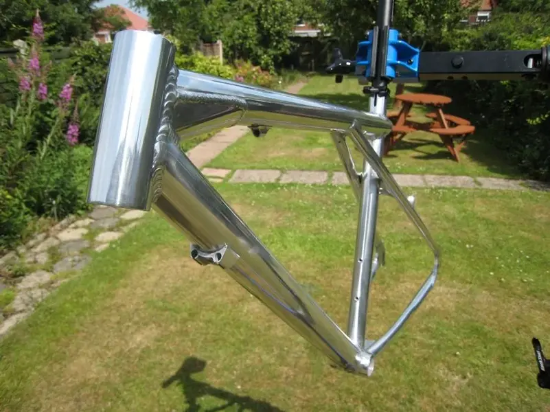

Zaskar back from the polishers :D

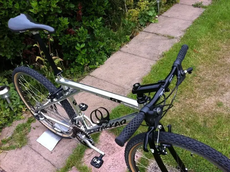

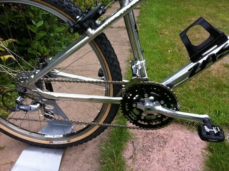

Final specs
Frame: '91 Zaskar 16" 03910115 2045g
Fork: GT 3D 812g
Headset: Tioga Avenger 132g
Cable hanger: alloy 17g
Stem: GT flip flop w/ ti bolt 364g
Handlebar: GT 174g
Grips: GT 70g
Brakes: XT front 181g, XT U rear 364g
Brake Pads: XT
Brake Cables: XT 45g
Cantilever cable hangers: XT
Brake Levers: XT 221g
Shifters: XT thumbies 189g
Front Derailleur: XT 129g
Rear Derailleur: XT short w/ SRP bolts 218g, Bullseye jockey wheels 27g
Derailleur Cables: SIS 52g
Cassette: HG50 308g
Chain: SRAM PC890 288g
Cranks: Syncros alloy 462g
Crank Bolts: Syncros Crank-O-Matic 26g
Chainrings:
outer: Stronglight 46t 100g
mid: Stronglight 36t 61g
inn: BBB 26t 42g
Chainring bolts: Shimano 23g
Bottom Bracket: Syncros HC double row 222g
Pedals: XT M737 512g
Hub Skewers: Ringle 50g/f 53g/r
Rims: Ritchey Vantage Expert 494g
Hubs: XT 140g/f 392g/r
Nipples: DT Swiss alloy 20g
Spokes: DT Swiss Rev 139g
Tyres: Ritchey Force K Racing 1032g
Tubes: latex 442g
Saddle: Flite Evolution I 154g
Seatpost: Syncros 225g
Seatpost Binder: Elite 504's excellent Ringle copy 25g
Bottle cage: Ringle 53g
Bottle bolts: SRP 3g
BB cable guide: Shimano 5g
Rear brake bosses: GT 32g
Cable crosser: GT 7g
Weight: 10.35kg / 22.8lbs

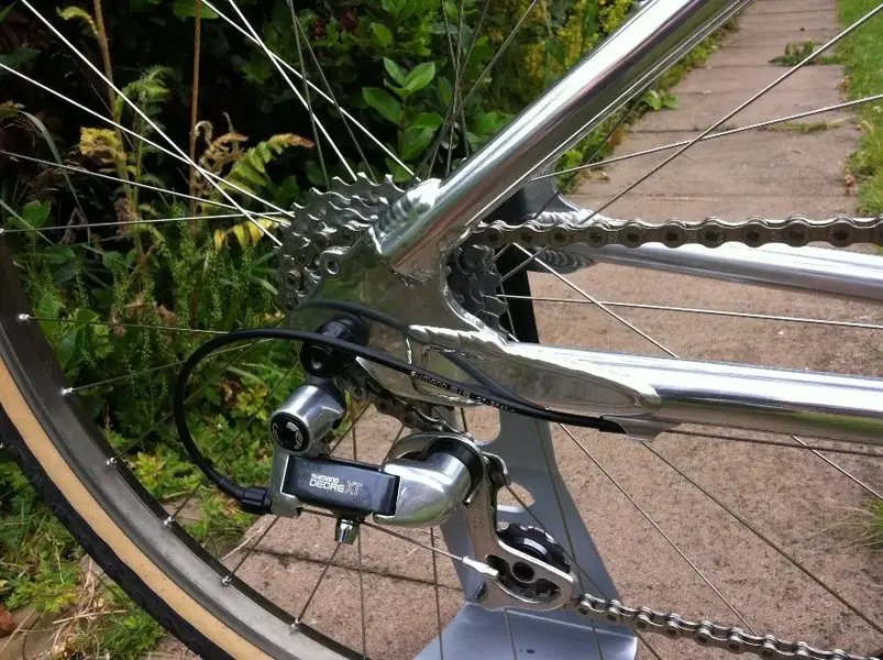

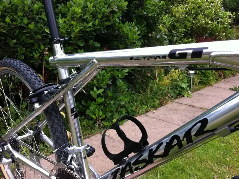

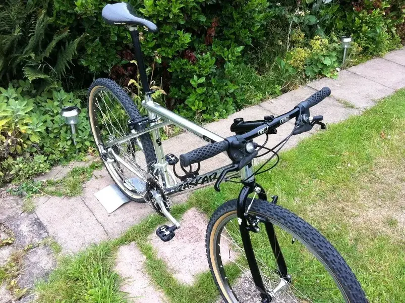

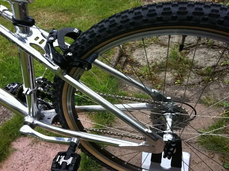

All finished now.

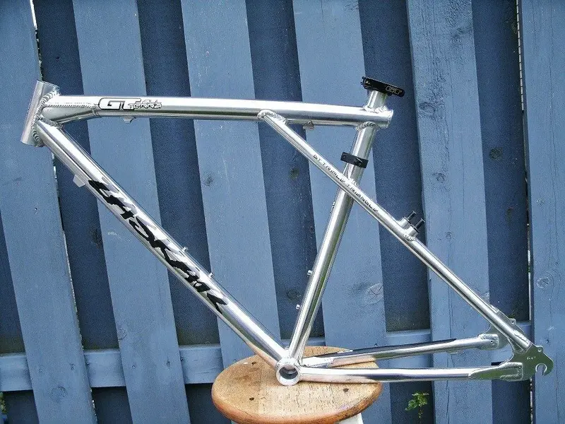

My new job slowed this build down, but my lack of confidence in making the decals really put the brakes on. I ended up using Gil's '91 + '92 sets as the basis and used some as they were (fork & seat stays) and played around with the others, a craft knife & some black paint to create the others (top tube, head tube & seat tube) to get a match to the catalogue. I am delighted, not to say relieved, with the finished results :D
I also had to grind the front cable hanger down a great deal to fit the relatively short steerer - and as I didn't have a bench grinder that meant running backwards & forwards between work & home to get the right fit.
All in all I'm delighted with this bike. The frame has ended up exactly how I wanted it and although not all the parts are strictly period (and may not be approved of by all) I think it looks spot-on & am looking forward to trying it out at Sleepless this weekend.
