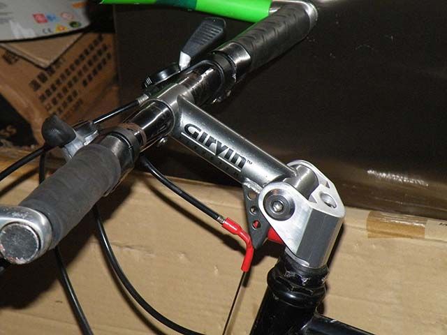

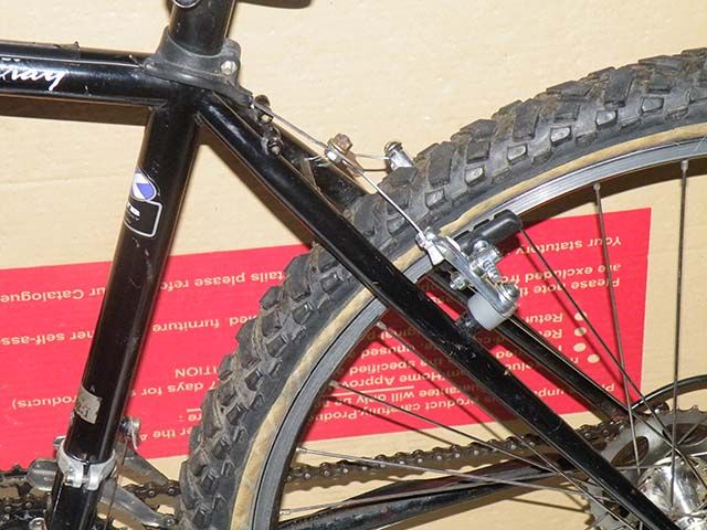

OK, couple of progress pics. First up the Flexstem, always wanted one when I was a kid so hit ebay and won one. Made the error of getting a 1" but its shimmed and sitting tight so no big drama there. You can just about make out the new BB, thanks again to FlufflyChicken for the info :) Finally there's some random canti's on the back end. When I was dismantling the originals for cleaning one started disintegrating so I had to grab a pair from the local shop, this was all he had so its just a temp quick fix for a tenner.

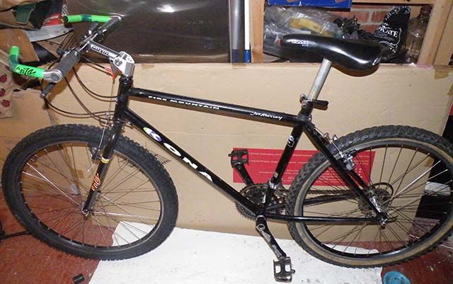

Attached hopefully is a picture of my '91 Fire Mountain.
It's slightly modded with a Girvin flexstem and v-brakes, although I need a better way to attach the rear brake cable rather than cable tied to the frame.
It's also got skinny tyres on it, but I've got the original 22 year old ones in the garden shed.
