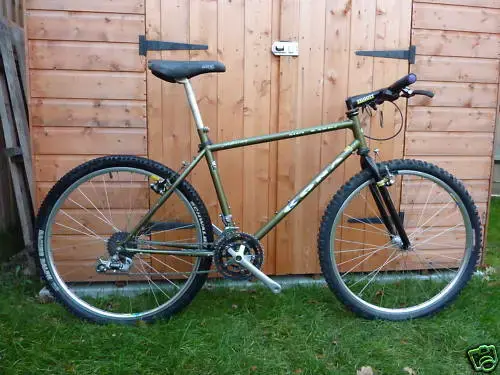

Hi,
I picked up a 91 Kona cindercone at the local market for £25. It's a strange mix of well looked after and not so well looked after - regreased fork steerer in the head tube and totally knackered forks and sticky, never been degreased shifters.
Now it's mostly original parts in pretty good condition, only the fork is an rst 461 and fully compressed cos its got now spring or oil or whatever the hell it's supposed to have, so I need a new fork - I'm thinking rigid.
Can anyone tell me what length fork will maintain the geometry. From a bit of googling it looks like 450mm but I can't find any forks that are that long. The closest I can find is the surly instigator at 448mm - is that a good choice?

The RST is an elastomer fork from around 97 or so, and it looks as though the elastomers have crumbled away to nothing as the fork is way shorter than it should be. I doubt whether there would be much point in trying to revive it to be honest, as elastomers aren't available and it wasn't much good in the first place.
The frame is designed for a 39cm fork, measured from the axle centre to where the crown race sits. That was the length they used up until 1993, and you will see a Project 2 for sale from time to time from that era. The exact one for 1991 is black as shown below. I think your bike is a size 18, i.e. 18.75" seat tube c-t and does it have a 13cm head tube? If so, you would need a 16cm threaded steerer.
On the other hand, if you want to stick with that aheadset and ahead stem, you will need an ahead steerer of 20cm absolute minimum. I think your best bet/only option for an ahead fork with a 39cm a-c would be a Pace RC30/31 where you can replace the steerer.
The alternative is to use a later Project 2 of 41cm a-c, which will give slightly less sharp steering, but not the end of the world and some people actually prefer it. P2s were ahead from 1997 onwards and they were black from 1998 onwards, but the triple-butted ones are best and you're more likely to find a triple-butted 97 than a later year. 97 were gunmetal grey.
I'm sorry if all that complicates the issue, but that's about it really.

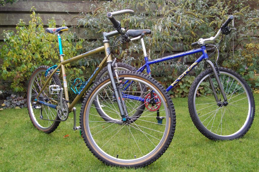

Hi,
Maybe I can help with the measurements.
I have a 1996 18" Cinder Cone with a threaded matte gunmetal gray tripple butted P2 and a 1997 16" Hahanna with an ahead shiny gunmetal gray "normal" P2.
On the picture below the Hahanna's fork is mounted on my 1997 16" Cinder Cone (blue one).

Re: P2
Aaldert":u3k0lhgv said:
Hi,
Nice bikes there. The blue one is in fact a size 18 and the gold one is a size 19, although they changed the shape/geometry so your 1996 size 19 has a 13cm head tube, which is the same length as on RetroSteve's 1991 size 18.
Nice subtle brake booster you went for!
