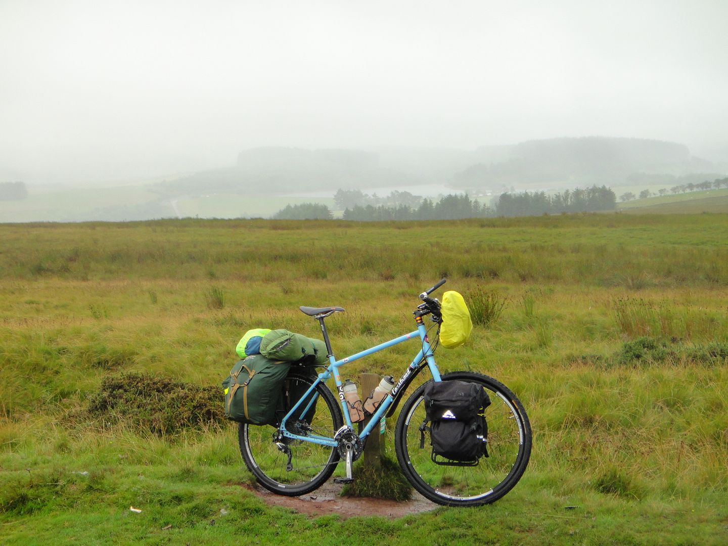

I rode the US Pacific coast on a Marin Palisades with bar ends and new wheels being the only mods from standard. It's fine.
However, I still have the frame and it has spent the past 20+ years with drops. They give you more hand positions plus the option of getting lower for downhills or punching into a headwind. The hand positions are more natural and comfortable (for me at least) and I don't get numb hands or pins and needles which I do with flat bars.
