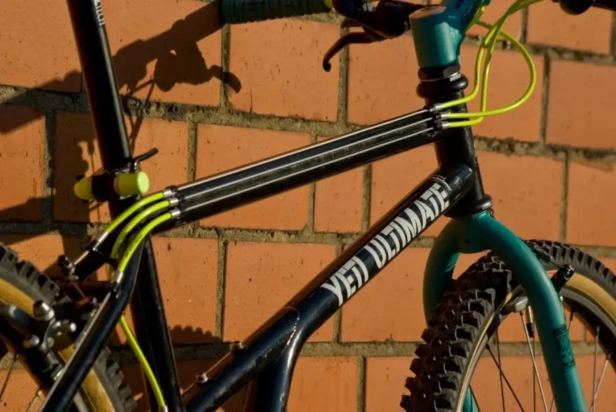

Which one(s) in particular did you notice were incorrect? (I'm striving for perfection here!)
"Middle" cable stop should be the front derailleur, and it should be routed inside the seatstay.
I think you're right. I just checked the Yeti catalogs and they show the front derailleur cable routed as you indicated. What's the benefit to routing the cables like that? I think it looks cleaner my way, without the overly big loop behind the seat tube.

Maybe the rear cable rooting is a matter of taste, but there is no need for a overly big loop behind the seat tube...

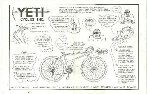

I'm sticking with the routing that I used. :wink: Here's the schematic I followed, which shows the rear derailleur cable in the middle position with the front cable in the bottom position. Sorry for the crap picture.
