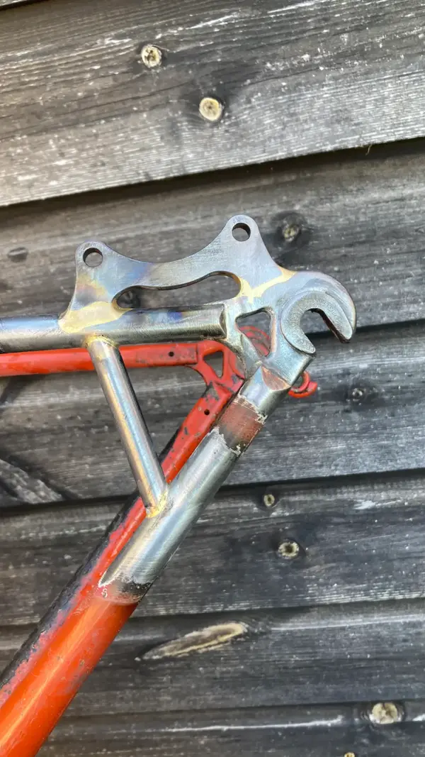

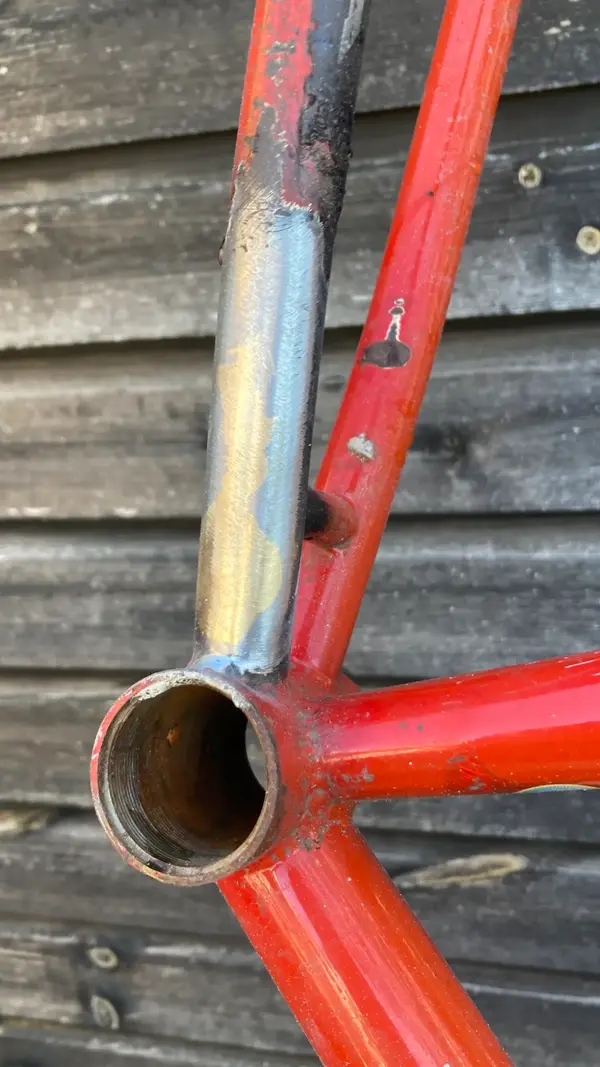

The frame had a dent on the underside of the downtube and some chainsuck dings on the drive side chainstay, I've filled these with Silver and Brass, The dent was only small and the chain suck was a dent and a deep scratch, no holes!
I've also removed the canti brake bosses and brazed on an ISO disc mount, brace and hydraulic hose guides.

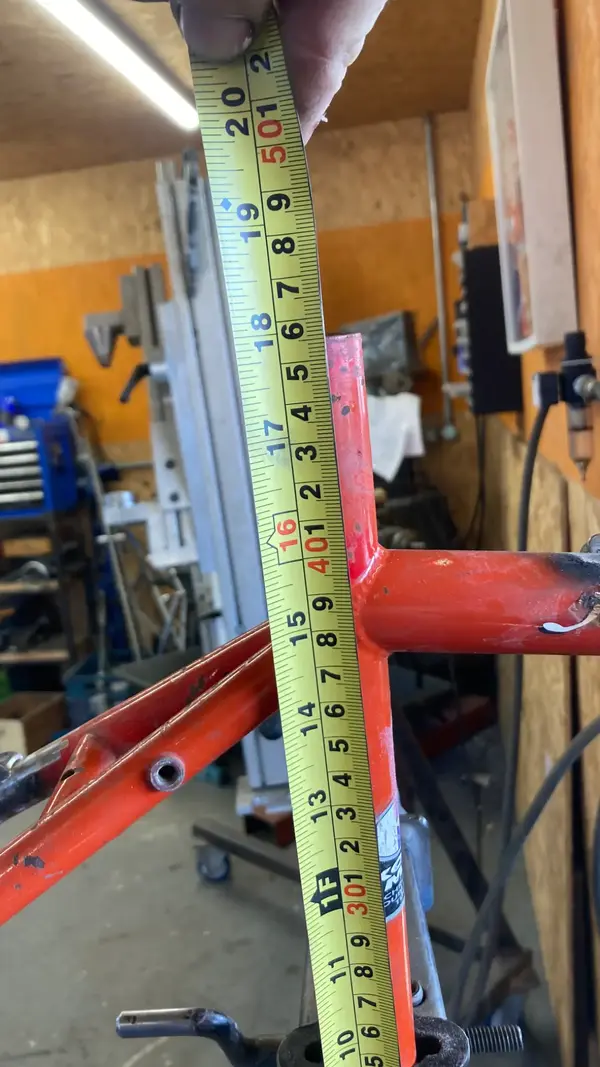

Trouble is, this frame is too small for me, I got a bit excited and ploughed on with the mods ignoring the potential size issue!

I've also checked the alignment of the frame, dropouts and derailleur hanger, something that Argos would have charged £80 for!
All threads on the frame are fine. I will chase/face/ream everything for the buyer before I ship.
