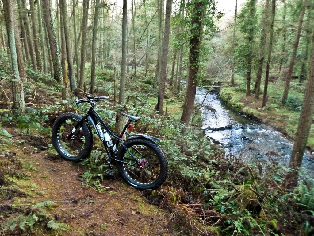

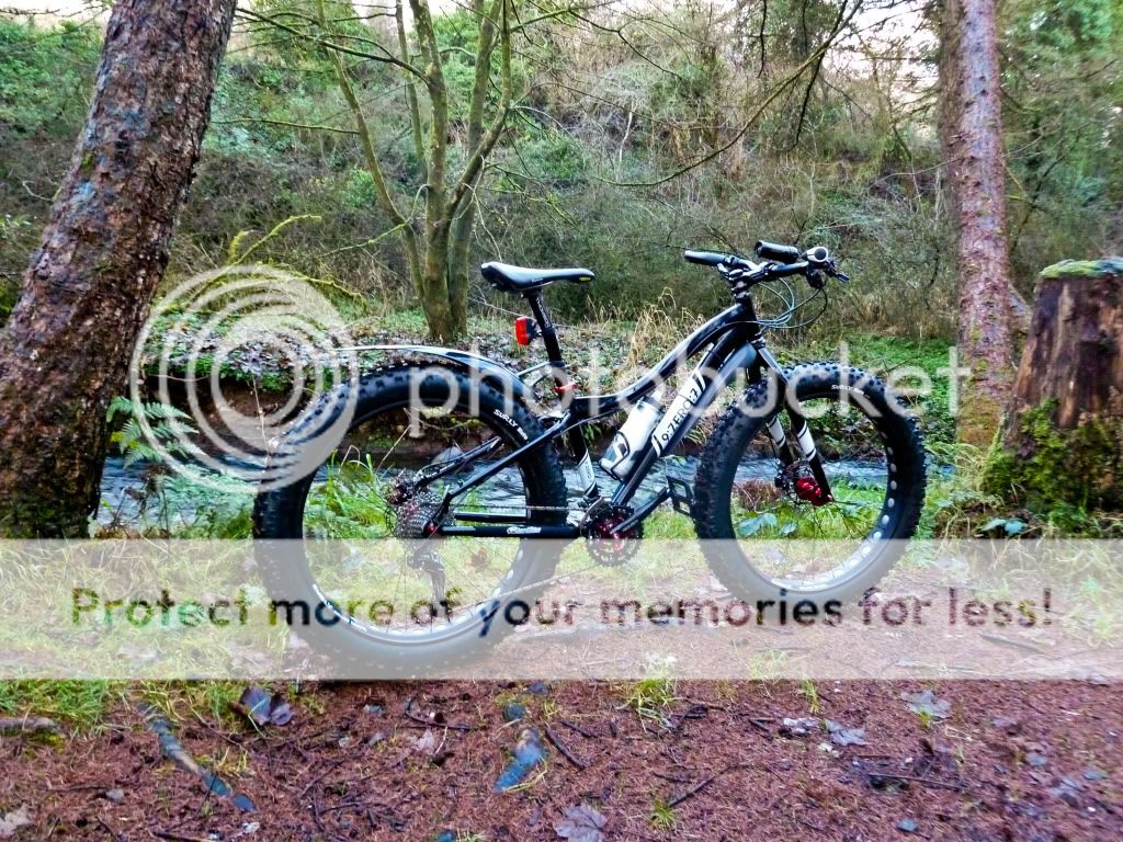

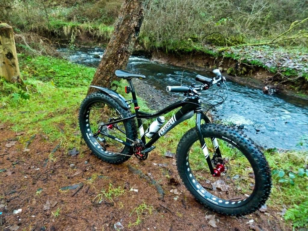

Bit of an update. I've replaced the 100mm stem and straight post for a Thomson layback post and 90mm stem and swapped the retro but heavy XT pedals for some plastic Nukeproof electrons, but I'll be keeping the Flite saddle (stamped 94) on there as a nod to retro coolness. I also changed the Middleburn 27-40 duo chainrings to a 20-30-40 triple setup with a pimpin' red spider 8) . With the BB centered in the frame I only had about 2mm clearance between the tyre and chain in the lowest gear, so I adjusted the BB cups towards the drive side by about 2mm for a bit more clearance.
I've also fitted a red Salsa seat clamp to add a bit of colour but I'm not sure if I prefer it to the black or not and I've fitted a crud guard to the rear. I hate the look of these things but its a bit of a necessity with the amount of muck the Nates throw up.
Some pics from todays ride -
:D :D :D
