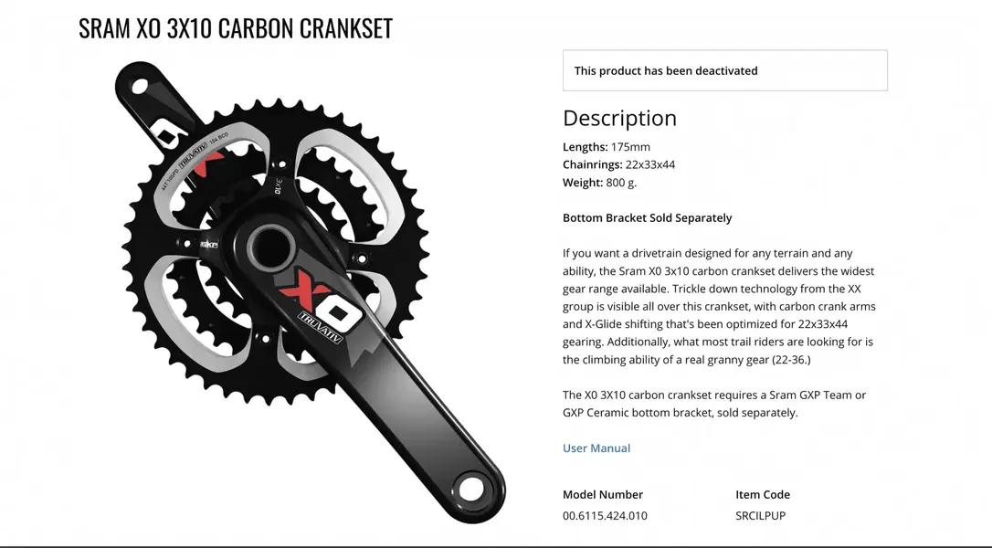

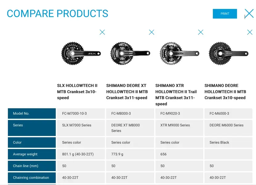

I’m after a bit of advice regarding a 9 speed triple chainset for use with my 26” hardtail.
I’ve spent the past 25 or so of my cycling years as a roady and only recently dusted off my 26” MTB as a bit of a lockdown project really (along with putting a steel hardtail together for the wife). Any hows, I’m looking to replace my chainset with a 170mm crank arm length type from the 175mm that’s already on there. The bike is a nicely kitted out Klein (on a 9 speed groupset). I’m not too worried about getting period correct so have been looking at what’s currently on offer from Shimano with the idea being I might be able to add chainring spacers to make room for a 9 speed chain (feel free to laugh at this point!). But, I have no clue whatsoever when it comes to MTB standards these days as everyone seems to be running x1 and x2 chain sets.
I can see on the Shimano site blurb there’s stuff written about boost spacing etc, which I’ve heard of (148mm, etc, etc) but I’ve never really took much notice as I’ve stuck to riding my road bikes since the late 90’s. Ideally I’d put a 9 speed triple on it but they’re pretty hard to come by from what I can tell. So I’m wondering if any of these Shimano 11 or 10 spd chains might work with the addition of chain ring spacers (please see attached).
The bike is built up with SRAM XO 9 speed and uses the cassette from that groupset.
