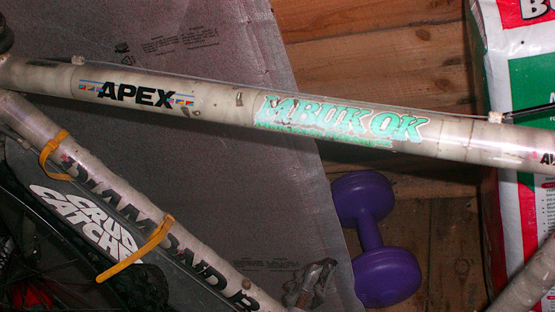

Suppose you could start by taking a good side on picture and adding it to the 80s Rides threads! Love that DB smoke paintjob 8)
:lol: Remember them MBUK OK stickers!
An old High School buddy had one of them, full Deore DX groupo with STI shifters. Was very jealous, as I only had my Raleigh Ravine at the time :lol:

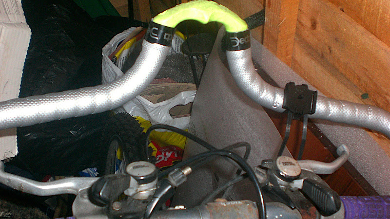

If it were mine, before doing anything I'd de-grease, take that handlebar thing off (sorry, but it doesnt suit it :wink: ), take all the damaged decals/stickers off (new ones can be sourced from gil_m on here) and then make a decision as to how the re-build is going to go.
