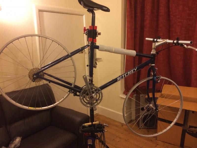

Started putting this together today, so thought I'd show some quick pics.
It's an '85 Ritchey that I'm giving to mrs311 to use. It will be getting plenty of use too - so a well proven slightly updated spec is the way it's going.

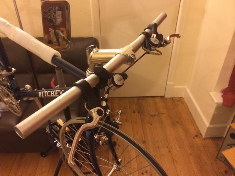

Ritchey levers and NOS M650 thumbies
Correct ritchey fork, basic dia compe front brake. (rear is a really trick dia tech CNC U brake)

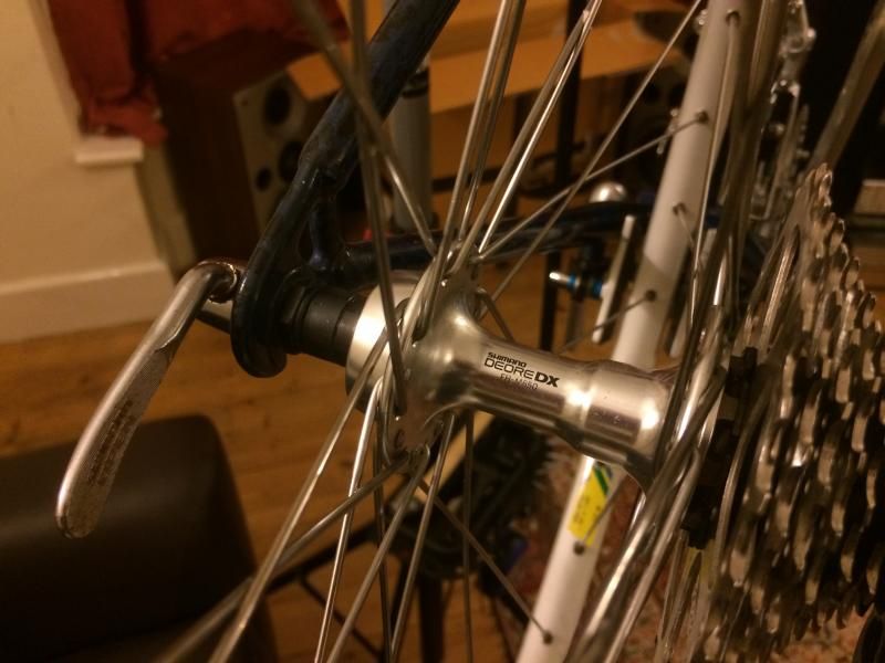

Early Ritchey logic chainset and NOS M650 front mech
Wheels are pretty much unused and perfect M650 hubs and equally perfect M321 rims
Rear mech will also be M650. Modern ritchey tyres etc.

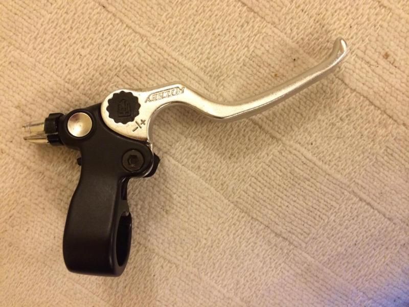

As with all builds - I had the obligatory total f*** up today. Setting up all the controls for mrs 311's riding position, I stripped the threads in one of the brake levers while setting the lever angles.
It's a blind tapped hole in very soft cast ally with no opportunity to tap it oversize so the ritchey levers, or one of them at least is now scrap :( It didn't feel like I was giving it any welly at all as I nipped it up, but sure enough *POP* and the threads pulled out.
If anyone by any small miracle has one of these that they want to sell then I'm all ears. Otherwise it'll be another pair of levers to finish it - I'm thinking dia compe ss-5 as they are still readily available new, work really well, and are pretty classic.
Wouldn't be a RetroBike if something didn't go pop entirely at random! Would've thought a little helicoil kit should sort it though?

You wouldn't get a helicoil in it because the hole for the other side of the clamp is in the way, and too small.
I've now got another pair of levers winging their way over from Denmark - so should be sorted and together by the weekend all being well :)
