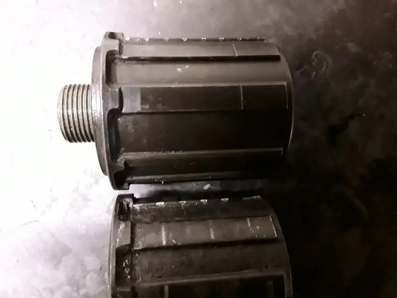

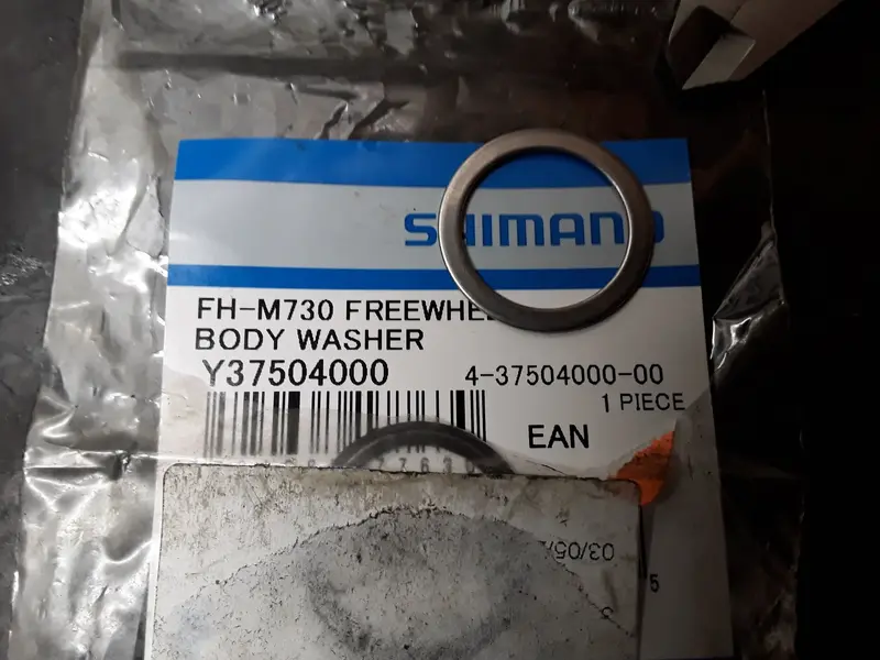

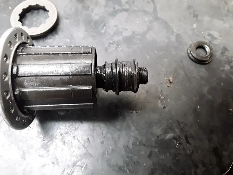

Heres a few pics. In no particular order!
1st is a problem you might hit, the raised section is often thinner on an 8 speed freehub, the cassette bolts then foul the hub.
2nd the spacer that solves the above.
3rd compaired hubs
4th finished hubs.
5th using a mix of the old cones and seals, respaced and swapped spacers....just keep putting the cassette on and trying it in the frame if your not sure of your measurements. The closer to the frame the less dish, the less spoke tension % difference, the stronger the wheel.

The main concern for me will be whether the 'star' on the freehub engages on the mating part of the hub - not visible until the freehub is removed, and there are at least 2 different Shimano designs.
Its really not a concern if you stick to older shimano stuff and I doubt he's doing to cannibalise an older durace hub for the purpose.
But yes, be aware there are different hubs out there. Also obviously freehubs from other manufacturers may not fit.
