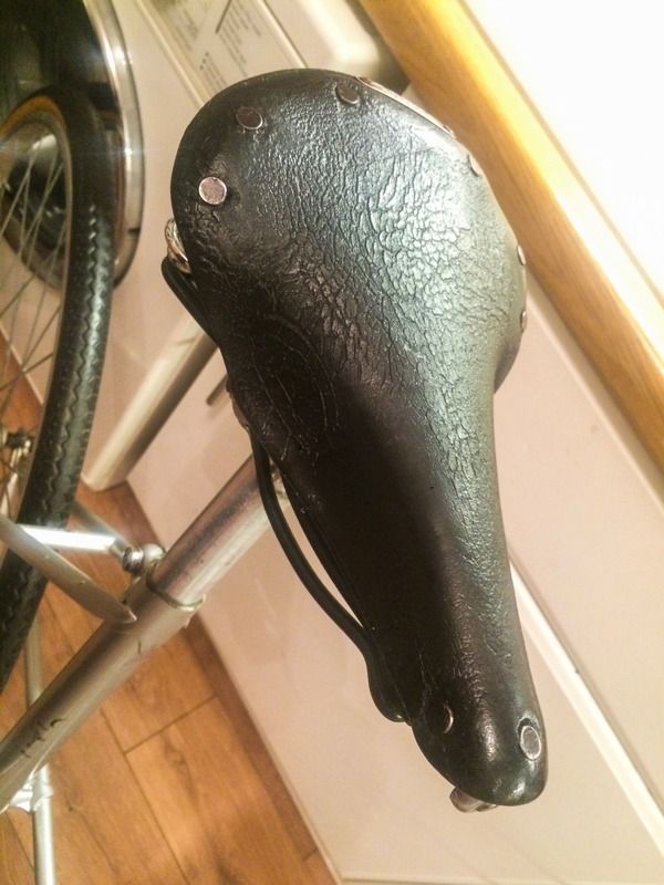

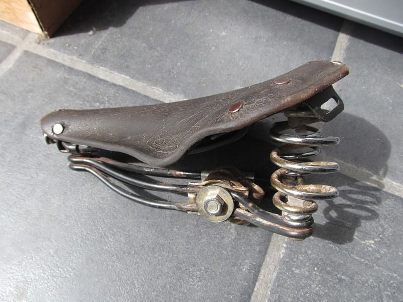

I got hold of a Brooks saddle for it - cheap because it needed some renovation work.

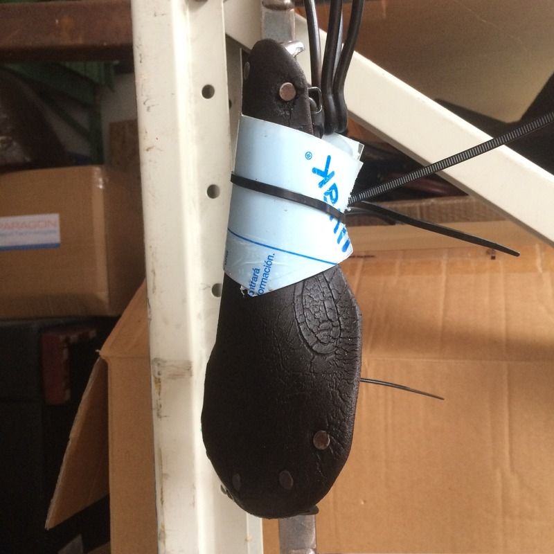

A pic from the ad - the leather had started to flatten out and it was quite dry and cracked.
Dismantled the framework, left to soak in water over night and then chocked it up and let it dry out to reform the leather. I noticed that the tension peg at the front wasn't located properly....maybe because the leather had shrunk back pulling it away - I'm not sure. As soon as the leather was supple enough it went back in place and allowed some tension to be applied to the saddle again - helping to maintain the shape.
Fed it plenty of Dubbin and started to work in some boot polish - aiming for a high shine. Starting to look quite nice - loving the aged look on it. The missus is not so sure I fear. I may be using this saddle on a different bike in the future.......... ;)

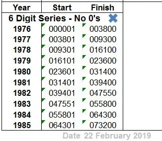

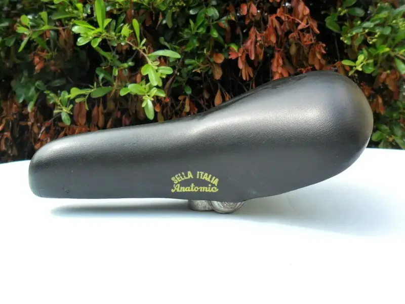

Re: '78 Claud Butler Majestique mixte......one for the missus
016364 - suggesting actually it's a 1979......my birth year which is a nice coincidence.
Thanks for the heads up on the saddle - I've no real idea on what was original fitment on the bike component-wise. I've guessed at Suntour VX derailleurs and I've gone for stem mounted Suntour shifters.......I assume there is a catalogue for the '79 range, but I've struggled to find it.

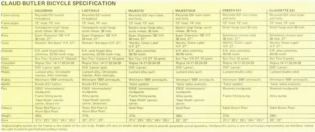

I don't think much changed between the late 1970's an early 80's on these, here are some snips from the '80, '81 and '82 cats...
