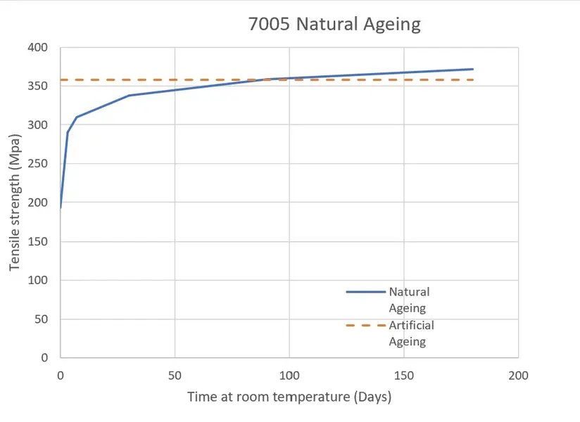

OK, it's not because of hardening of the 7005 material.
That's already done and finished soon after the frame was built. Additional time barely increases tensile strength etc
Manufacturers will usually carry out an artificial age cycle post-weld (Put it in an oven, 10hrs @ 150°C, or similar) to drive a consistent ageing result. However, 7005 will also naturally age harden at room temperature (20°C) over a few weeks post-weld, so heat treatment is not strictly necessary, just advisable for business insurance/quality control/traceability etc. After ageing (natural or artificial), you need a lot more than warmish climate temps to make any difference to the alloy.

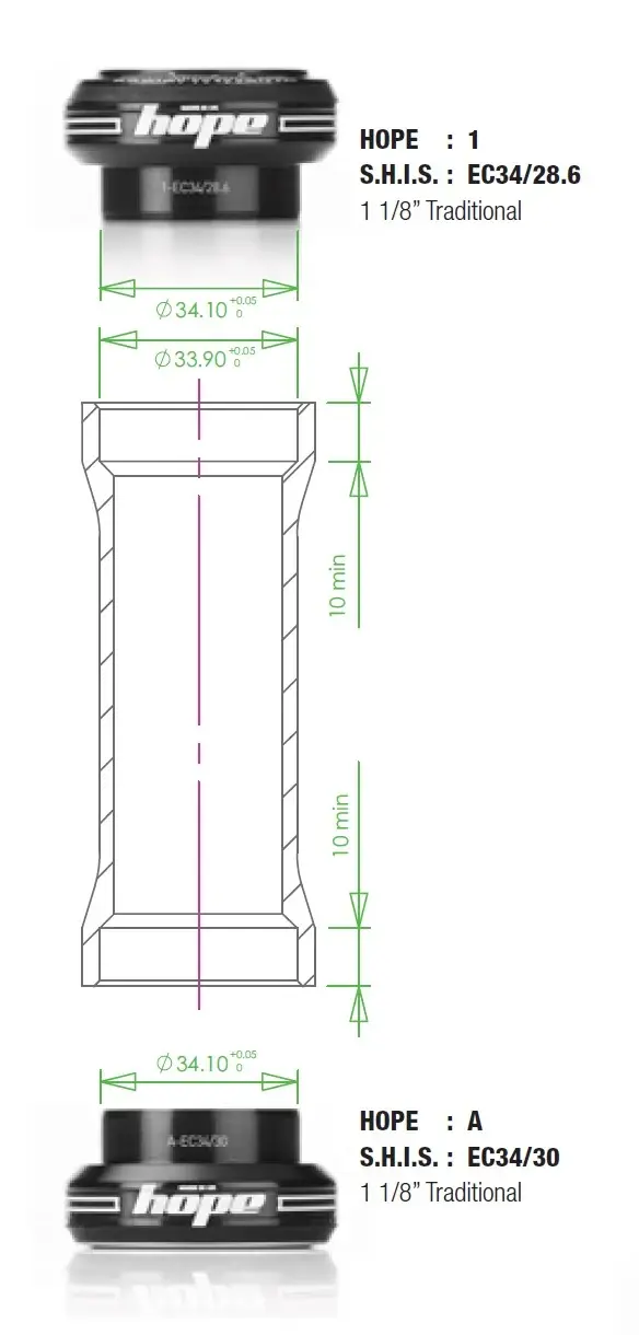

Firstly, aluminium alloys are roughly 70% less elastic than steel (Modulus of Elasticity + Poisson Ratio); they react less well to the stresses of press fitting. The published standard tolerances for the headtube/headset fit were devised for steel frames. These were followed by the aluminium frame manufacturers without any adaptation for the characteristics of the new material. Consequently, aluminium frames experience higher localised stresses than the material should have.
Here's the published Hope specs for their 1-1/8" cups: 34.10mm +0.05/-0.00, headtube bore 33.90mm +0.05/-0.0, so 0.25mmØ max interference, 0.15mmØ minimum.

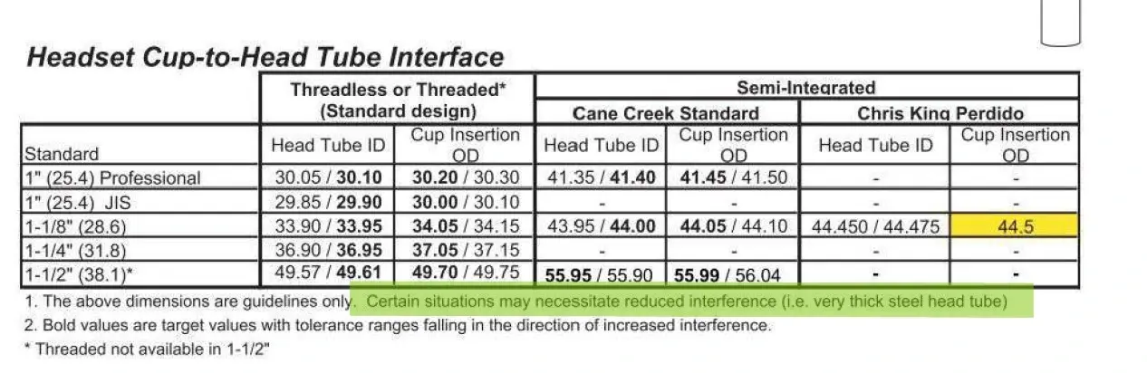

Here (from Cane Creek), you can see that the more modern 'Semi-Integrated' systems, although still press-fit, have a far lighter fit tolerance (Max 0.15mmØ / Min 0.05mmØ) than the older 'Standard' cup tolerances.
