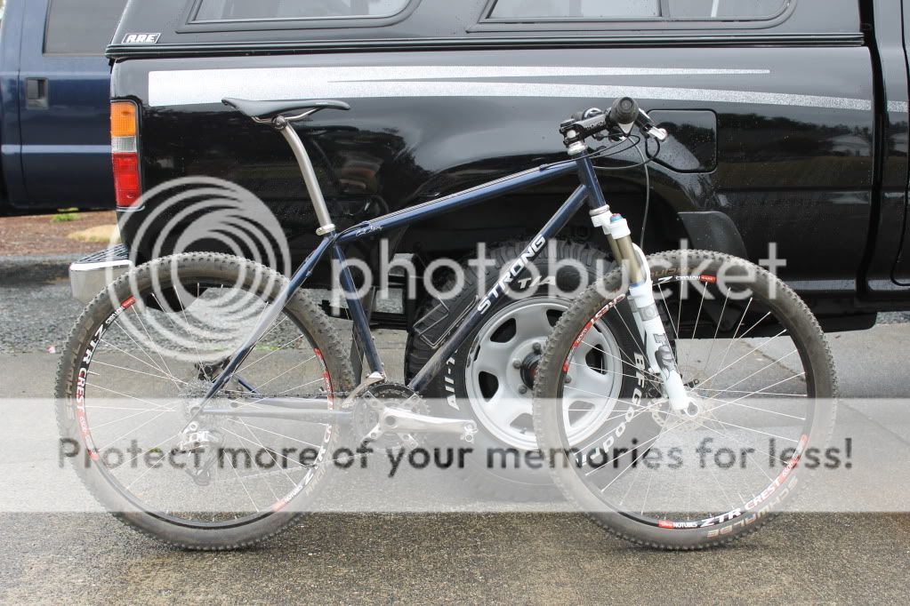

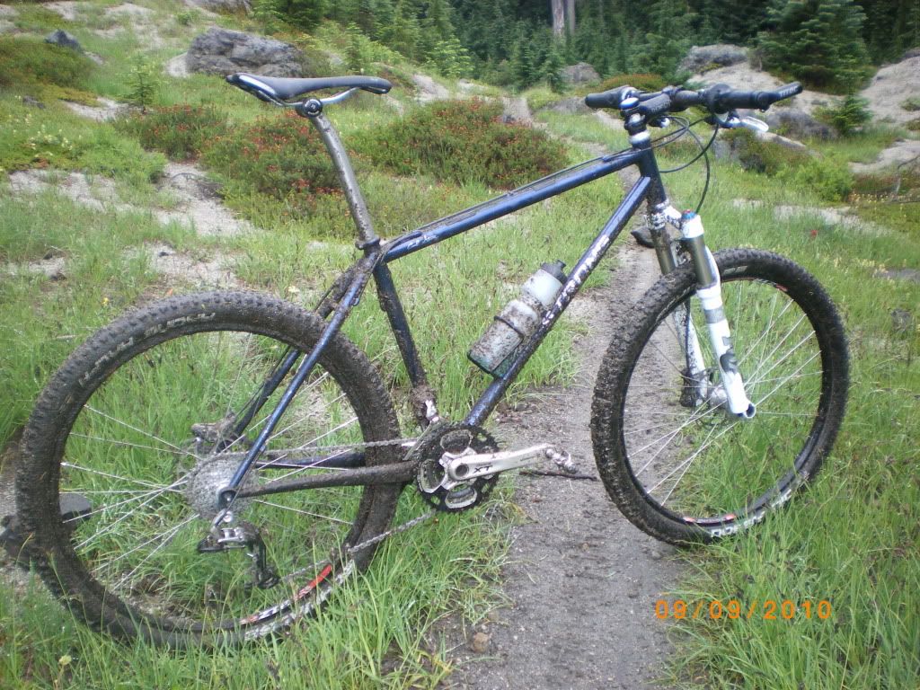

I've been quite pleased with my 650b conversion. The difference is subtle but noticeable. It raised my bottom bracket around half an inch but the extra height is actually a good thing for me. My favorite riding areas are full of rocks and roots so I can pay less attention to avoiding pedal strikes now. I think Cannondale's Beast of the East had around a 13" bottom bracket height and mine is around 12.5" sagged. I was due for new tires so I thought I would just spend a few extra $$$ and build up some 650b wheels.
Bike fit, set up, and your own bike handling skills are still #1 in my book. 650b just gives a slightly different feel that I like and I would definitely do it again. Here is an older pic in 26" mode and a new pic in 650b mode.
