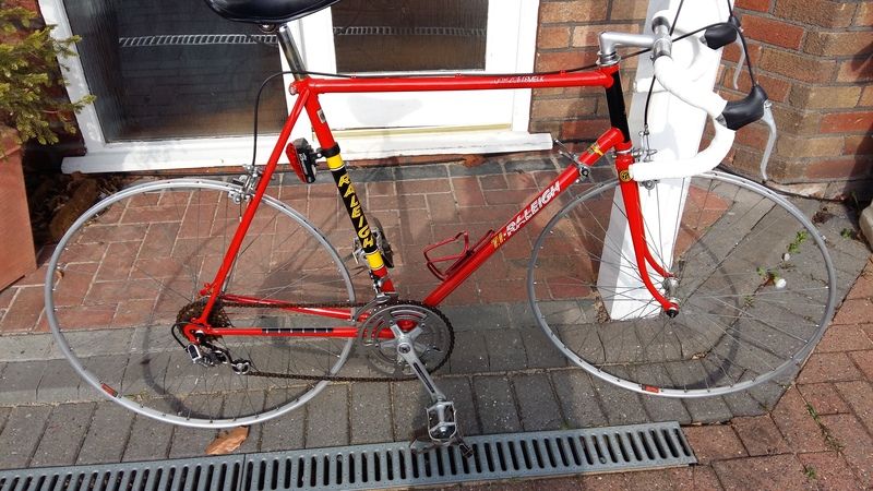

thankyou shaun...im just learning at the moment...im hoping to put a set on for my dad to use at his leisure..dont need anything special just as long as it has a tube in in case he gets a puncture
These are nice rims and has a cassette (yes, its an early casette) that will fit your rear end..........which you need to measure but should be 126mm. You can also use a freewheel type of hub as well for that era.
Just an example really as we need to know the OLD / OLN of the wheels that you have. That is the distance apart the dropouts are, makes it a lot easier if you buy the right sized wheels
Hope that makes sense.
Actually I'll put those wheels on my watch list
Shaun
To be honest anything at the moment to get him going
Whilst going a search on a few this comes up: QUICK RELEASE ALLOY REAR HUB 135mm O.L.D
The rear dropout external measurement is 126mm what does the 135mm mean and will it fit?
I have some 5spd quick release wheels available but if were mine, I'd fit tubs.
