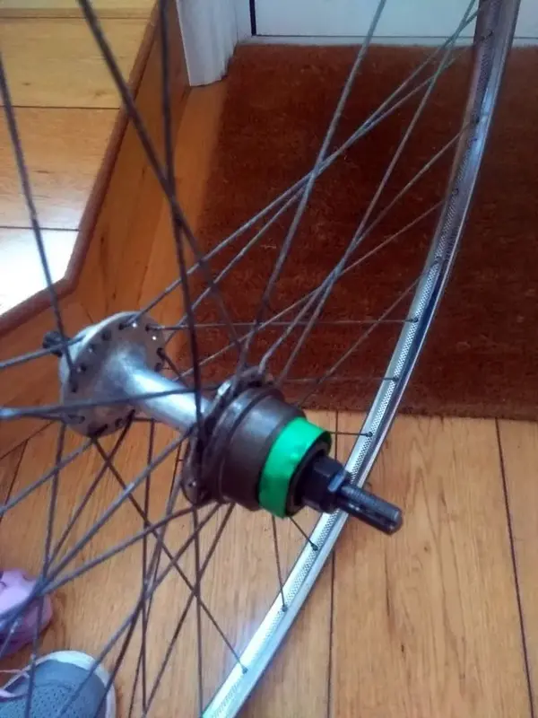

I have a wheel I want to respoke and I need to remove the complete freewheel to fit the drive side spokes as the spokes still catch when you try to insert them as you can see most of the original spokes are bent close to the hub. freewheel.jpg I have removed the cogs but I need to know how to remove the rest.
The green tape is just to protect the pawls.Although I have done a few bikes I have never done this .
Can you do a picture of the remaining part end on as there are any different removers and you will need a good vice too.
I will Tomorrow but there doesn't seem to be anything that a tool can be used on this hup is 1970s so none of the modern tools seem useable.
