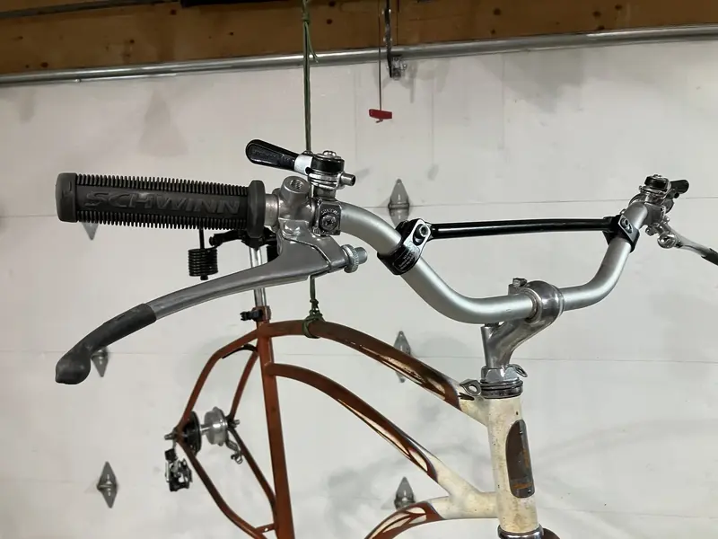

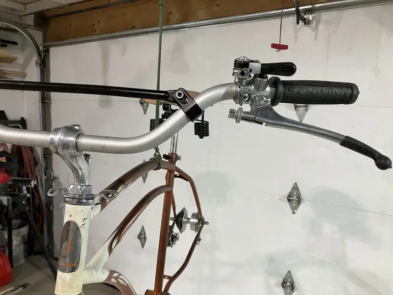

Ya they’re crazy but Im trying to loosely follow along with Alan Bonds list of materials for the fisher replica so we’ll see how it goes.The bars look great! That's a serious motorcycle lever for the brake. Hardcore

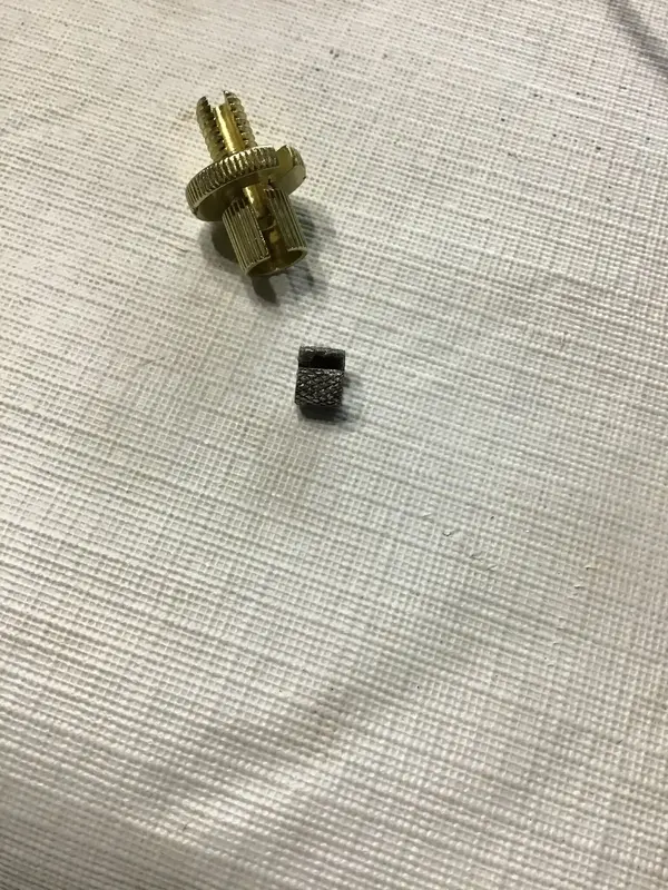

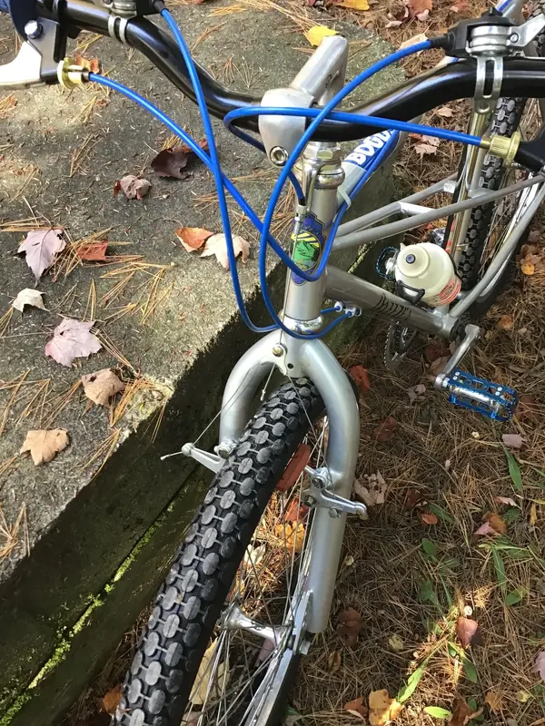

Ahh perfect thanks for the advice!!Here is how I shimmed my motorcycle levers to accept the smaller bicycle cables. I used a bicycle brake adjusting barrel and a small thin brass pipe from the hardware store.
View attachment 885946View attachment 885948View attachment 885949View attachment 885947

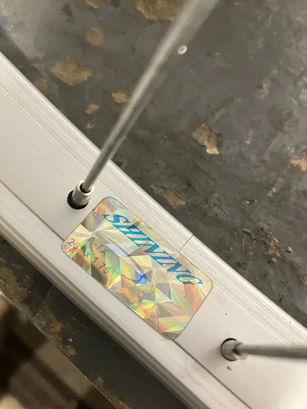

Gold is good.View attachment 887683View attachment 887684

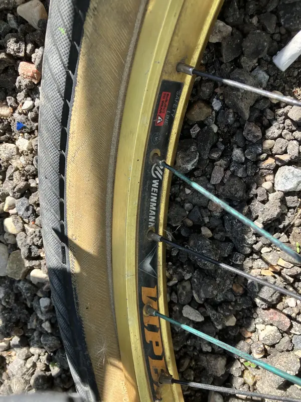

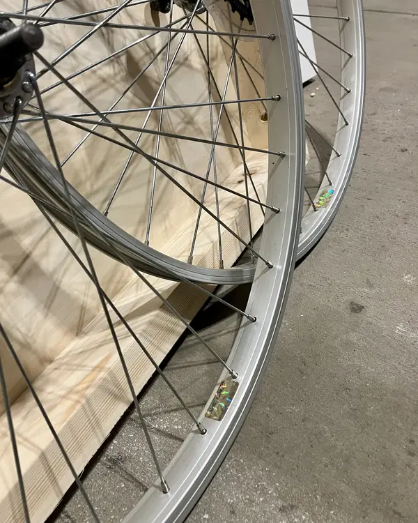

Found a bike at the auction with these rims any thoughts if they would work for this build? I think gold with this frame would be sharp.
