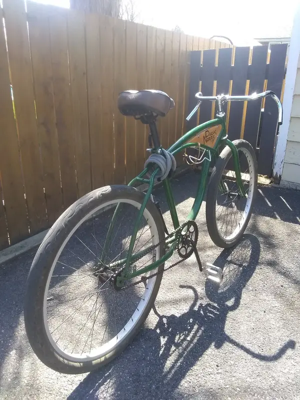

40’s Schwinn DX klunker Build?
Curious, can handle bars be bent? I’d love if these flared out.
Yes! can be a bit tricky, but again I'm sure you have the skills.
1. Need to be able to clamp properly in an engineers vice without deforming the tubing. You can make make something like a tubing block frame builders use made from hardwood such as beech/oak to secure the bar.
2. Then you need a thick gauge tube over the end of the bar as your lever. This tube needs to be a good fit so you don't crush/deform the end of the bar with the inner wall of the lever pressing against the bar, unless you can plug it with something solid.
Need to watch out where you clamp and replicating it on the opposite side so you don't end up with wonky bars can be tricky! I used to be into Raleigh Choppers (well still am to be honest!) so have played around with tweaking bars before. You shouldn't need heat either, but again depends on what leverage force you can apply and how thick gauge the bars are.
