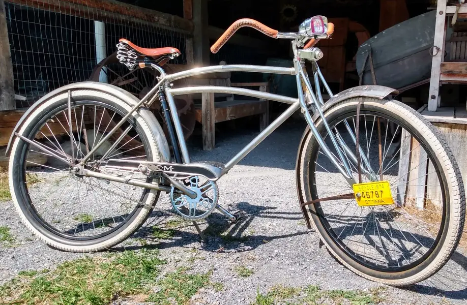

That looks like a CCM Moto, be careful, might not be 26" tires. They were available in 28 as well. @Ingola did a bare metal ratrod Moto, the bike is awesome 208853-IMG-20220828-135723145-HDR-2.webp
He can probably give you the entire history of CCM while explaining specs. He was collecting CCM before I got him onto the trails

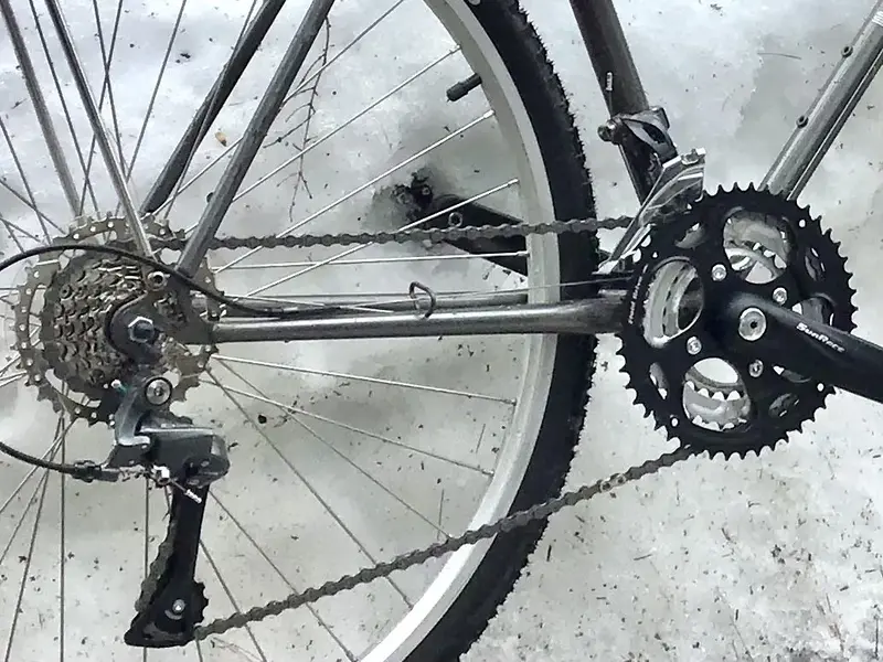

Here is a vintage bicycle that I put a triple on and a 6 speed megga range cassette. Square taper bb. C0C5F82F-3CA2-45A5-8612-0B44599141CB.jpeg

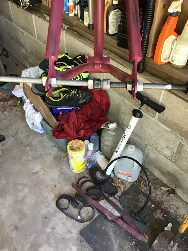

I spread the stays. Here is a better photo of the tool I made to check for parallel and correction. FDF32515-70C0-4D8F-B805-A7767F746090.jpeg
